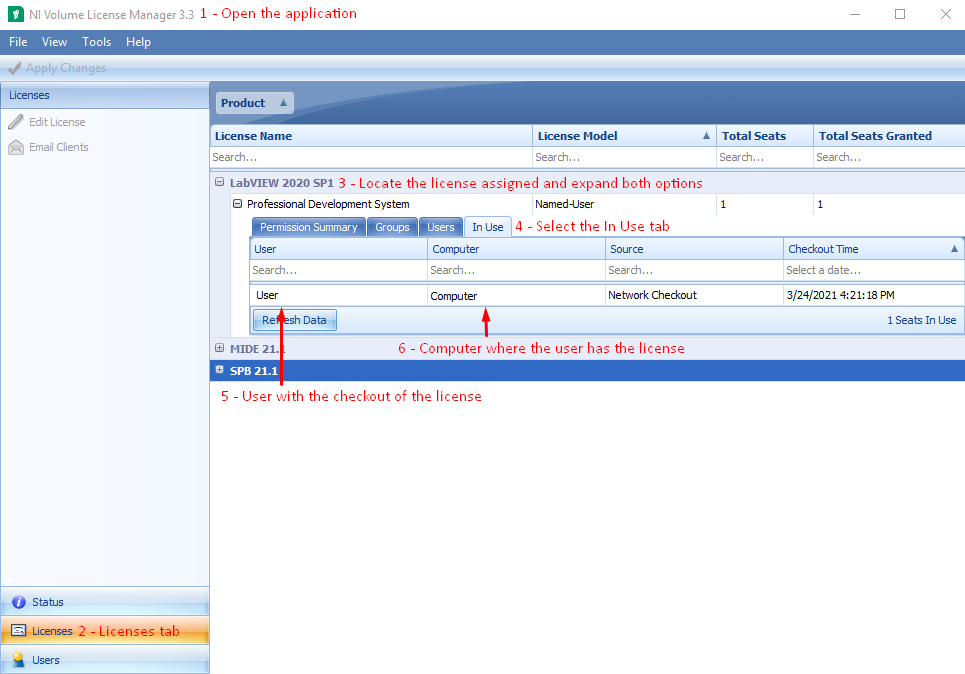

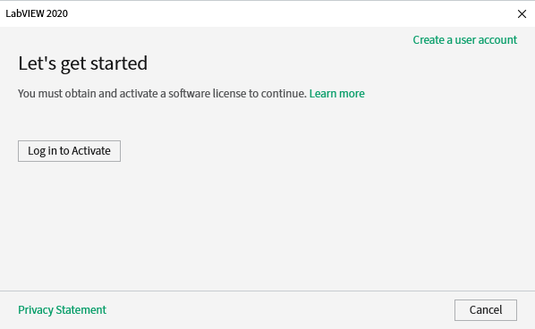

  • I have been granted a license from the licensing server, but when I try to open the software, the activation wizard pops-up requesting the activation.
The main reason why you are seeing this behavior is due to you are using a named-user license and the license has been checked-out on another computer with your user.
Depending on the software or machine you are, you can review if you have the license on another computer with the following steps:
NI Volume License Manager - NI VLM
  1. Open NI VLM
  2. Click on the Licenses tab
  3. Locate the license assigned to the user, and expand the license by clicking in the + at the left
  4. Select the In Use tab
  5. If you can locate the user, then the license is checkout in another computer
  6. You can see the user and computer name where it is being used

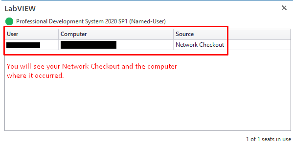

Client Machines
  1. Open NI License Manager
  2. Click in the Network Licenses tab
  3. Locate your assigned license
  4. Review the i icon at the end of the line
  5. A new window will appear, showing the license checkouts
If you see your user listed there with another computer, you can close the software on the previous computer and now you will be able to use the license on the actual computer.
