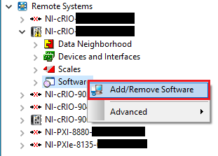

Expand the target. Right click and select Add/Remove Software.

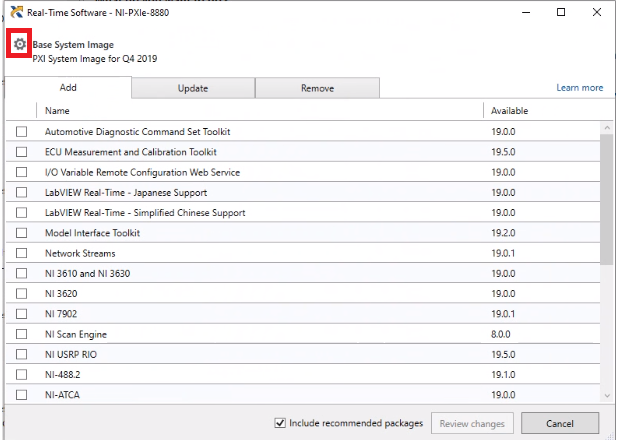

If using a new/formatted device, select the Base System Image to be used on the target. The available versions can be accessed by clicking the gear icon on the left-hand side. Once the selection has been made, click OK.
A base system image contains the operating system and components to manage NI software through feeds located on NI website or a user-specified location.

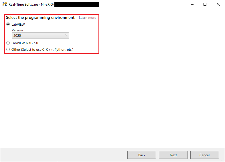

Once formatted, select the programming environment to use on the target and click Next.

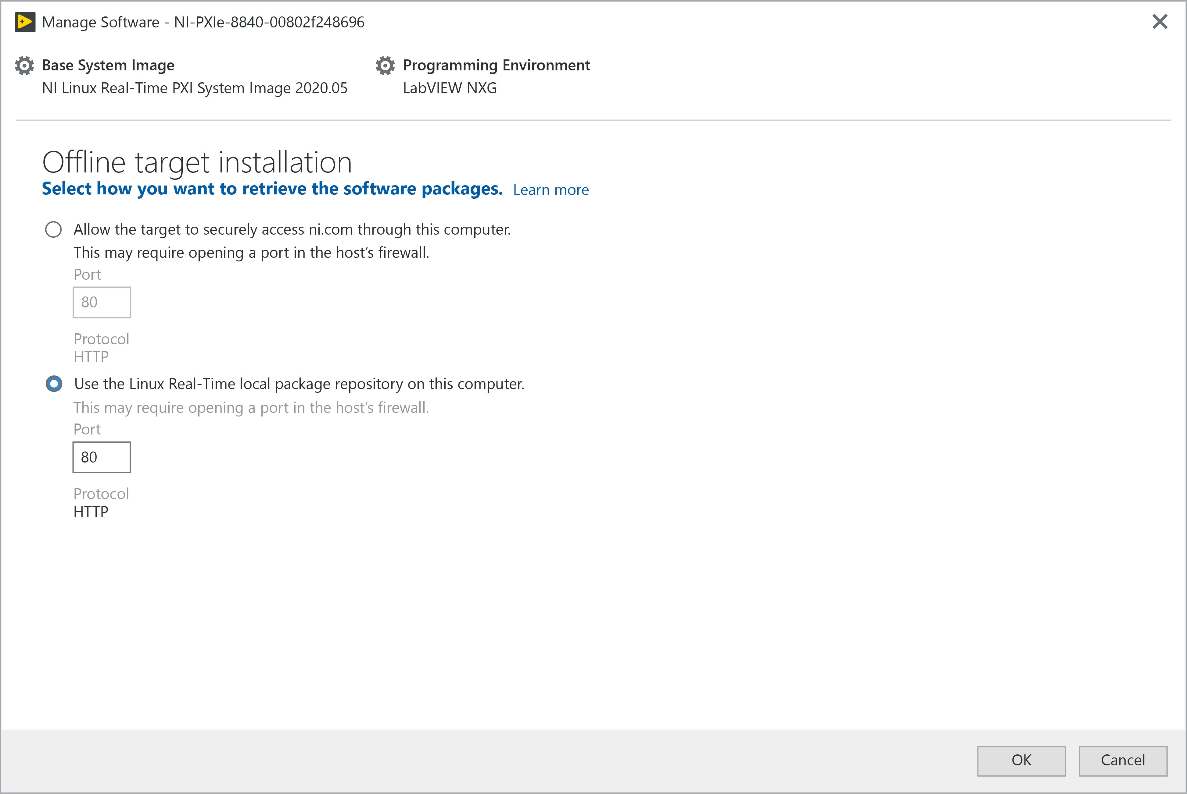

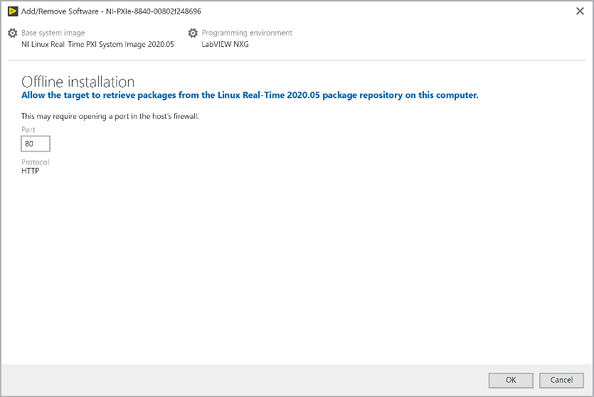

Select Allow the target to retrieve packages from feeds hosted on this computer and click OK. It might be necessary to select another port if the preselected port is unavailable. The look of the page will be different if the host PC is online or offline:
• Online Host PC
• Offline Host PC

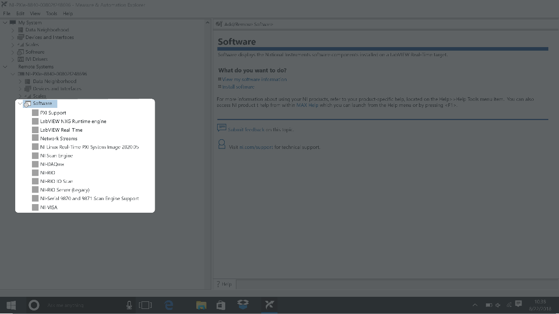

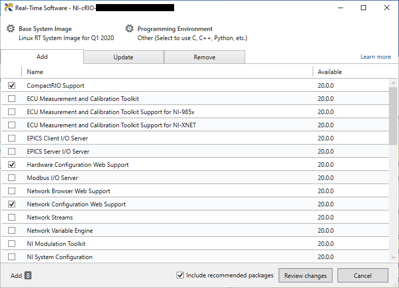

Choose the packages to be installed on the target and click Review changes. Packages are preselected based on the target's base system image and programming environment.

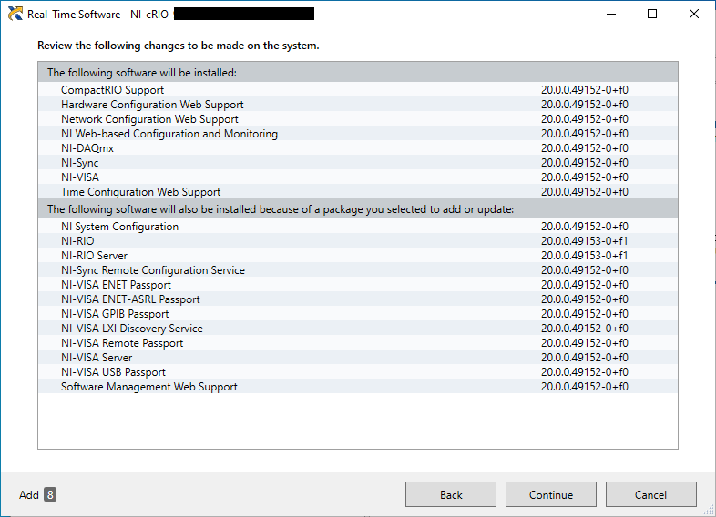

Review the packages that have been selected for installation and click Continue to retrieve the packages from the host PC and install them onto the target.

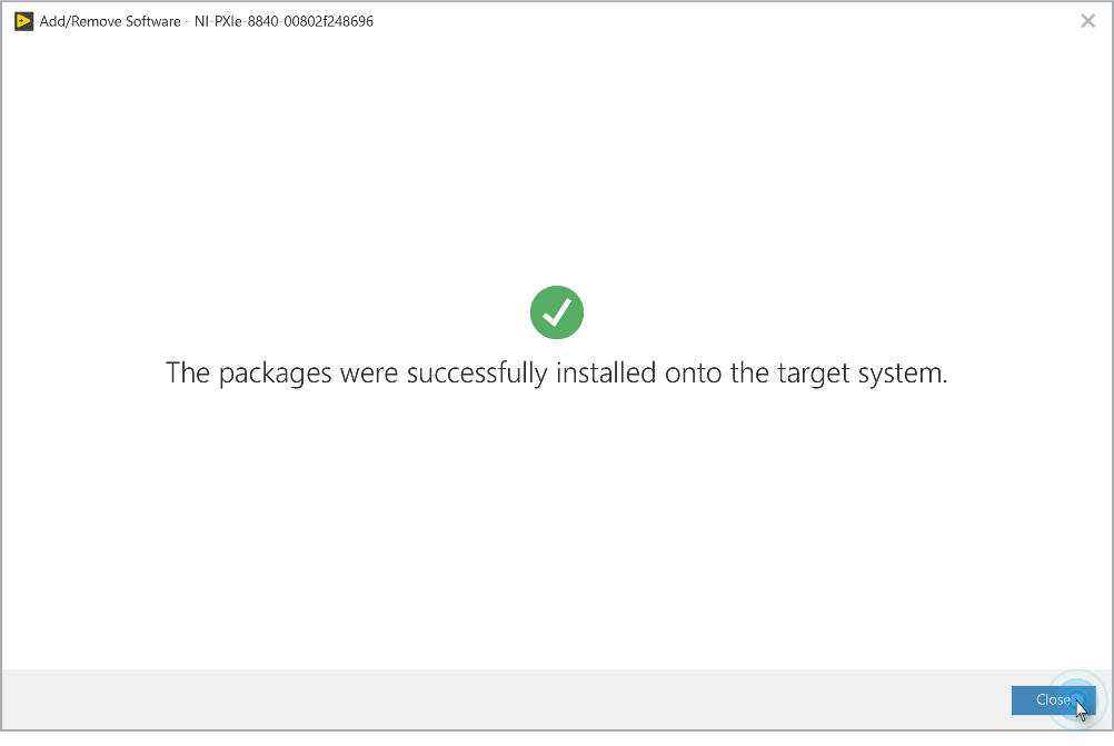

After installation is complete, click Close to dismiss the success dialog.

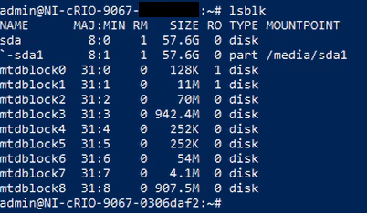

- Connect the USB drive to the target and locate its mount path by typing lsblk in the shell.
- Run the following command to generate the local feeds:
- find /USBMountPath -name 'Packages.gz' -exec dirname {} \; | awk '{print "src/gz local" NR " file://" $0}' > /etc/opkg/local.USBfeeds.conf
- Replace /USBMountPath with the actual path. In this case, it is /media/sda1
