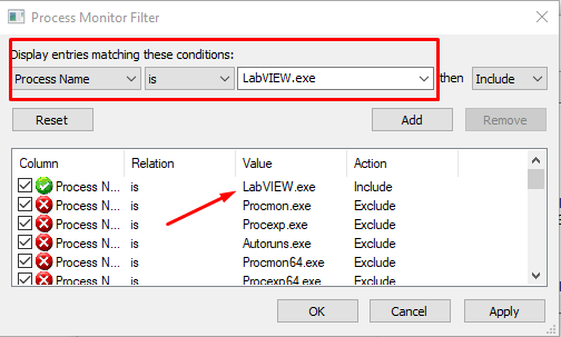

From the menu, click Filter»Filter... In the Process Monitor Filter window, select Process Name, then select is, LabVIEW.exe, and finally Include; then click Add followed by OK.
