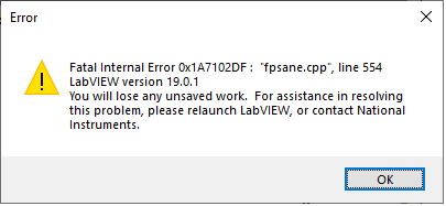

This message means that an object in LabVIEW such as a wire or a loop tunnel does not pass an internal test known as a sanity check (see examples of insane object errors in Additional Information below). If the errors are serious enough, LabVIEW exits because something has become corrupted. Sanity checks occur before each save, to ensure that corrupted VIs are not written over good VIs. They also happen as part of the compilation process. Thus, sanity checks happen frequently. Many insanities are actually fixed (made sane) after the dialog box appears and will not appear again, so the first thing you should do after receiving an insane object error is to try to make a backup copy of the VI, run it, and perform some additional editing to see if the problem was resolved automatically.
VI corruptions do not happen often. They can happen because of disk corruption, but this will often lead to a file that can no longer be loaded. Corruptions can also happen because the programmer did something that corrupts a LabVIEW data type, perhaps as the result of a call to external code.

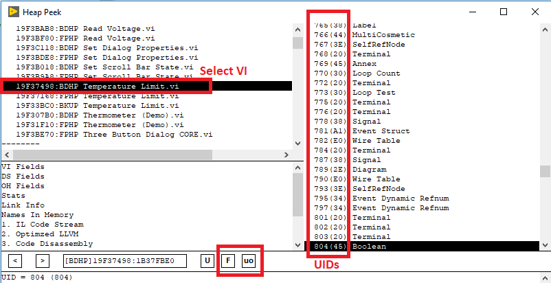

- Look at the error log and determine if the problem appears to be with a component (wires, controls, indicators, etc.) on the front panel ("FPHP") or block diagram ("BDHP") (see Error Log contents section below). Delete and recreate the most recently created objects and make use of the text in the error message in deciding which objects to rebuild. Example: In the case of the second message above, it would be best to delete and recreate the most recently created loop tunnels. There is also a way to directly find the objects from the error log messages as explained in the Finding insane objects section below.
