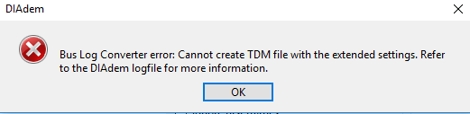

I'm using the DIAdem's Bus Log Converter to produce TDM files, but I am receiving an error:
Bus Log Converter error: Cannot create TDM file with the extended settings. Refer to the DIAdem logfile for more information.
This error can be caused by incorrect settings in the Bus Log Converter or incompatibility issues between DIAdem and the file type. Ensure that your logfile adheres to the accepted data, and make sure that all the communication buses are defined by the appropriate bus database file. For the following file types, please try the suggestions listed below:
