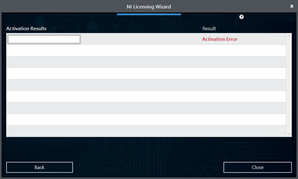

安裝NI軟體並嘗試在NI License Manager中啓用它後,我收到以下錯誤訊息:
Activation Error
