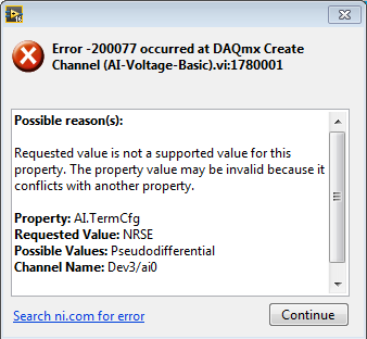

  • DAQmx Create Channel (AI-Voltage-Basic): Error -200077 is occurring due to NRSE being the currently selected value. Changing this to Pseudodifferential will resolve the error. If you are encountering a similar error but believe your device should support the value you have selected, check with your device manual to verify which pins support which measurement types by following the Product Documentation website.

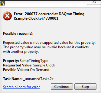

  • DAQmx Timing (Sample Clock): The "Sample Rate" value needs to be changed, or the Mode should be changed to On Demand. Since the DAQmx Timing VI (Sample Clock) doesn't have the On Demand value, we need to use DAQmx Timing Node instead of Sample Clock, as shown in the screenshot below.

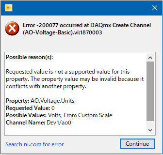

  • DAQmx Create Channel (AO-Voltage-Basic): Suggested input values (Volts or From Custom Scale) should be used for units for analog output (AO) tasks.

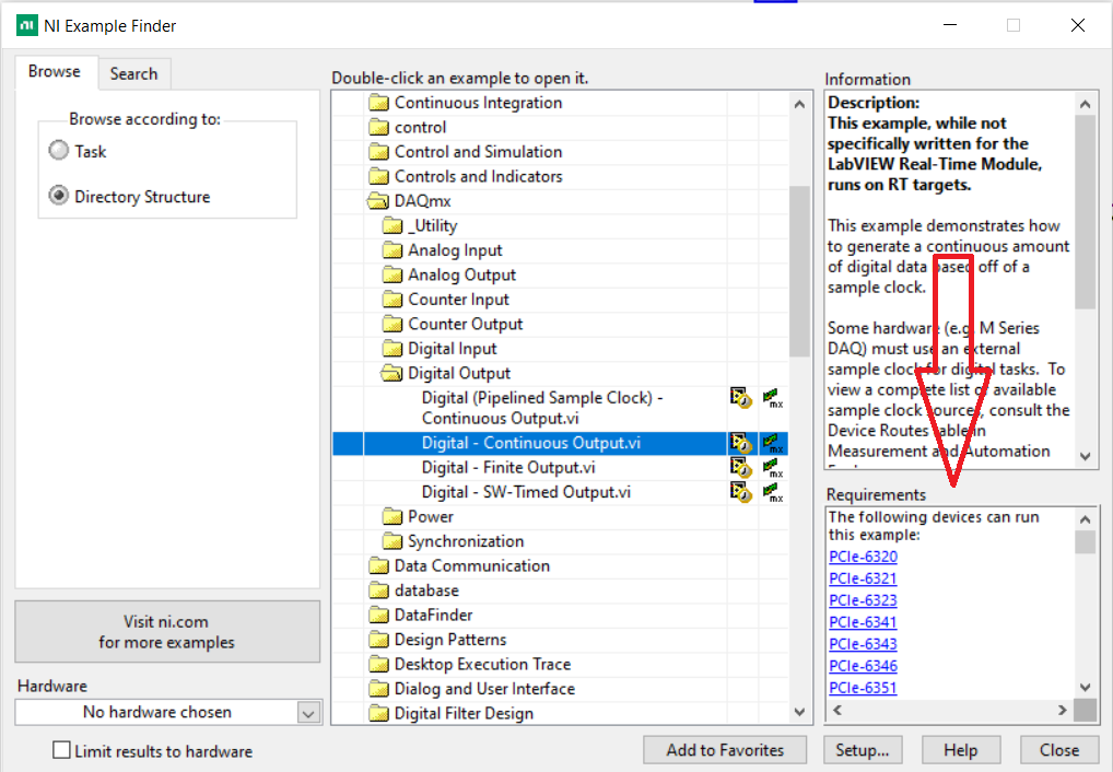

If running a Shipping Example (LabVIEW example code that provides by installing the LabVIEW), verify the device you are using is supported with that example by checking under its "Requirements" section in the NI Example Finder.
