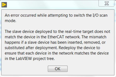

An error occurred while attempting to switch the I/O scan mode.
The slave device deployed to the real-time target does not match the device in the EtherCAT network. The mismatch happens if a slave device has been inserted, removed, or substituted after deployment. Redeploy the device to ensure that each device in the network matches the device in the LabVIEW project tree.

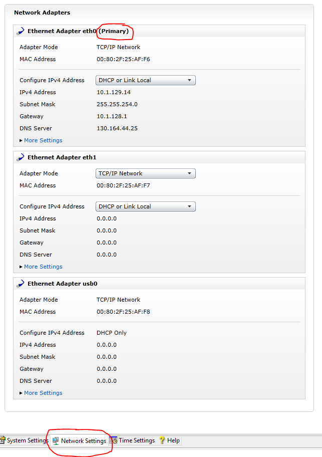

  • The primary Ethernet port on a Real-Time (RT) controller cannot be used for EtherCAT communication. One cause of the errors mentioned above is attempting to use the primary Ethernet port for EtherCAT communication. You can check which Ethernet adapter is primary in NI MAX by navigating to the Network Settings tab of your target (see screenshot below).
