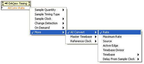

    You can manually set your convert (channel) clock using the DAQmx Timing property node. After placing the DAQmx Timing property node, left-click on the property selector and select More>>AI Convert>>Rate. Then, right-click on the property and select Change to Write to be able to change this property.
    Note: If using a Compact DAQ module for analog input, you must first set the active devices so that the module you are acquiring with is the active device.  To do this select the timing property More>>AI Convert>>Active Devices. Once you have selected the active device, you can expand the property node and then select the More>>AI Convert>>Rate property.
Note: If you don't see the property listed but the User Manual for your device says that is supported you can display the property by following these steps : Right Click Property Node >> Select Filter... >> Show All Attributes
