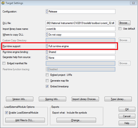

  2. Go to Build>>Target Settings and change the following settings:
    1. Change the Run-time support option to Full run-time engine, as shown in the image below

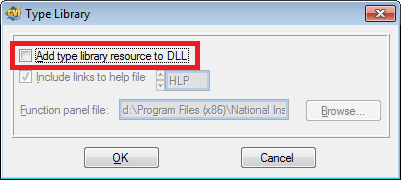

  1. Change the type library settings by clicking Type Library  and unchecking Add type library resource to DLL.  If you do not uncheck this option, you may run into a type definition error when attempting to build, similar to Definitions for these types could not be found.
Then click OK to exit out of both windows.

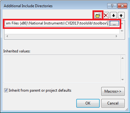

  2. Open your Visual Studio C++ project, and go to Project>>Properties. In the Properties window, go to Configuration Properties>>C/C++>>General. Click the Additional Include Directories field. Then click the arrow that appears and select <Edit...>.
  1. In the dialog box that opens, click the New Line button, add the directory that contains the header file and click OK.
