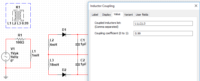

Using the INDUCTOR_COUPLING component
Use this method if you already placed and configured standard inductors in your schematic:
  1. Select Place » Component from the main menu.
  2. Select Basic in Group.
  3. Select the Transformer family.
  4. Find and place the INDUCTOR_COUPLING component into the schematic.
  5. Double-click the INDUCTOR_COUPLING, go to the Value tab, enter the inductors to couple into the Coupled inductors list: (Comma separated) field and put the desired value into the Coupling coefficient (0 to 1) field.
This method can also be used to couple more than two inductors.
Refer to Inductor Coupling in the NI Multisim™ Help for further details.

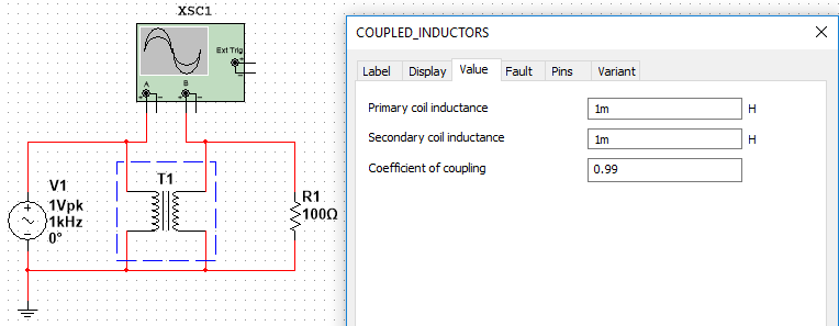

Using the COUPLED_INDUCTORS component
The second method is to use COUPLED_INDUCTORS component:
  2. On the left side of the Select a Component dialog, select Basic from the Group drop-down menu.
  3. Below, select the Transformer family.
  4. Find the COUPLED_INDUCTORS component and place it into the schematic.
  5. Double-click the COUPLED_INDUCTORS and enter the Primary and Secondary coil inductance values, as well as the Coefficient of coupling.
Refer to Coupled Inductors in the NI Multisim™ Help for information on the component's parameters.
