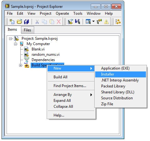

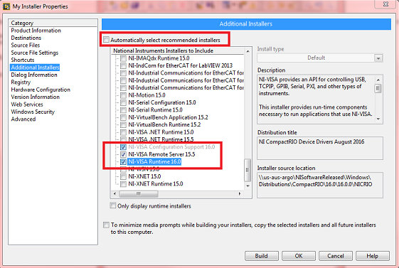

  1. Make sure the VISA Runtime Engine is installed on the target machine. You can create an installer using the LabVIEW Application Builder that includes the VISA Runtime or Install the VISA Runtime Engine manually by downloading the desired version from NI Downloads VISA Runtime Engine. We recommend including the Runtime Engine in the installer as it will be sure to have the correct version for your application and is the most scalable solution.
LabVIEW 8.0 or later
From the Project Explorer window, right-click on Build Specifications, select New»Installer.
If you already created an installer, then right-click on your installer and select Properties... Navigate to the Additional Installers category and check NI-VISA Runtime. In some versions of LabVIEW, you may need to uncheck the Automatically select recommended installers check box before you can add additional installers. The NI-VISA Configuration Support is required to deploy VISA settings and configure VISA resources in NI MAX.
Note: The installer will include the LabVIEW Runtime Engine by default, which is necessary to run any application built using the LabVIEW Application Builder.

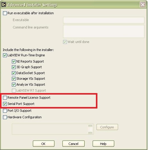

LabVIEW 7.1 or earlier
Click the Installer Settings tab, click the Advanced button, then place a check mark in the Serial Port Support checkbox. This will actually install the full serial portion of the NI-VISA Runtime Engine.
