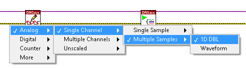

There are 3 ways to resolve this issue depends on your application.
1. Writing multiple samples to the buffer at a time:

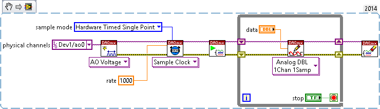

2. Writing single samples at a time with Hardware Timed Single Point (HWTSP)
3. Writing single samples at a time with On Demand
Error -200609 is caused when the amount of data being placed into an output buffer is too small. This typically occurs when a single value (per channel) is being inserted into an output buffer that is not configured for single-point DAQmx writes. This error is a result of the fact that Finite Samples and Continuous Samples sample modes require a minimum buffer size of 2.
