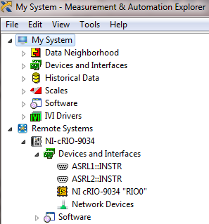

I am able to see my CompactRIO (cRIO) under Remote Systems in NI Measurement & Automation Explorer (MAX).  However, when I expand Devices and Interfaces under the cRIO, I can't see my C Series I/O modules. Why can't I see the C Series modules in MAX?
Only cRIO controllers with NI-DAQ™mx capabilities (cRIO-904x and cRIO-905x) and cDAQ systems provide access to C Series modules through NI MAX. If you are using a cRIO-904x or cRIO-905x, please ensure that NI-DAQmx is installed on your system. If NI-DAQmx is not installed, follow the instructions in the Getting Started with CompactRIO Hardware and LabVIEW tutorial. Note: If you experience problems installing NI-DAQmx, you may need to reformat your cRIO device and reinstall the software.
If you are using any other CompactRIO controller, C Series Modules will not be listed in NI MAX. Instead, the two potential options you have for detecting the Modules are listed below:

Each C Series I/O module interfaces with the FPGA. Therefore, NI-MAX is not able to determine which C Series modules are inserted into the cRIO chassis. Once you create a cRIO project, LabVIEW will download a personality to the FPGA that detects which modules are inserted in the cRIO chassis and you will have an opportunity to detect inserted modules to view in the project explorer.
A cRIO without NI-DAQmx capabilities will enumerate in MAX similar to the following image:
