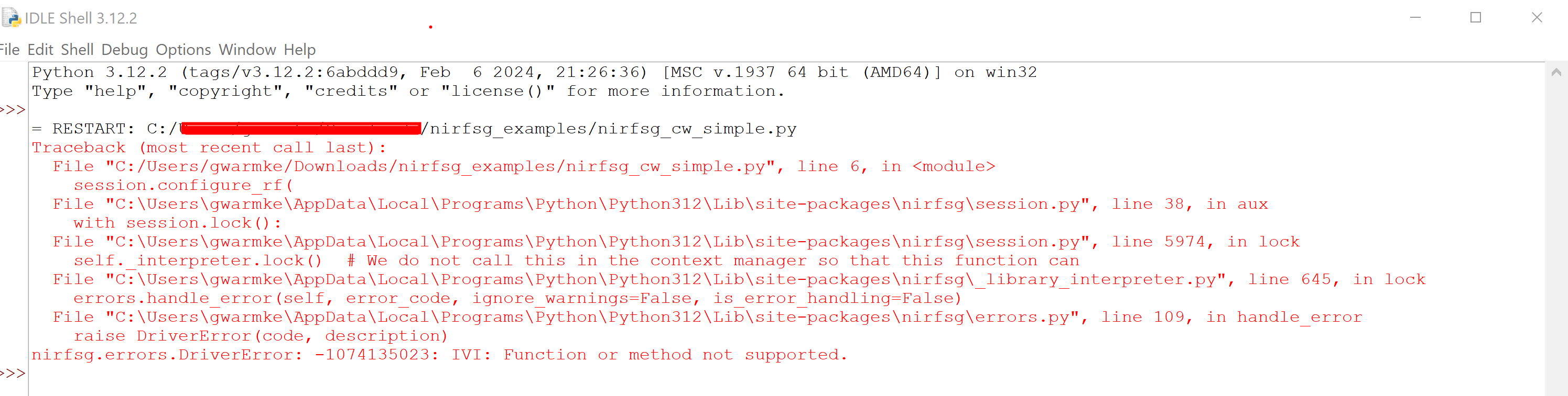

Error -1074135023 When Using NI-RFSG Python API
Updated Oct 7, 2025
  • NI-RFSG
Programming Language
  • Python
I am attempting to use the NI-RFSG Python API but when I run the program I am getting Error: -1074135023: IVI: (Hex 0xBFFA0011) Function or method not supported as shown below.
The NI-RFSG Python API support starts with version 2025 Q2 of the NI-RFSG driver. If you are using a version of the driver older than 2025 Q2, please upgrade to this version or newer in order to use the Python API.
You can find additional information about the NI-RFSG Python API, as well as other NI drivers, from the NI Github page. Documentation and examples for using the NI-RFSG Python API can also be found here
