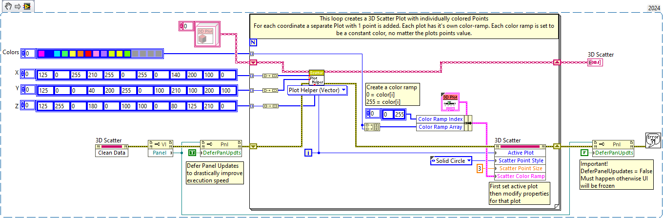

I'm using  3D scatter graph and want to set individual colors for the points in my plot.
The points in a single plor are always colored based on the plots color ramp. To color individual points there is two possibilities:
  1. Use individual plots
    You can add multiple plots to the graph, each having it's own color ramp with a constant, individual color.
    Drawback: slower performance for many data points
  2. Use a custom color ramp
    You can keep the points in a single plot and define a color ramp that has multiple sub-sections for the range of individual datapoints.
    Drawback: two points with the exact same value can not have different colors.
NoteIn order to use this snippet, download this image, and then drag and drop it on your LabVIEW block diagram.
