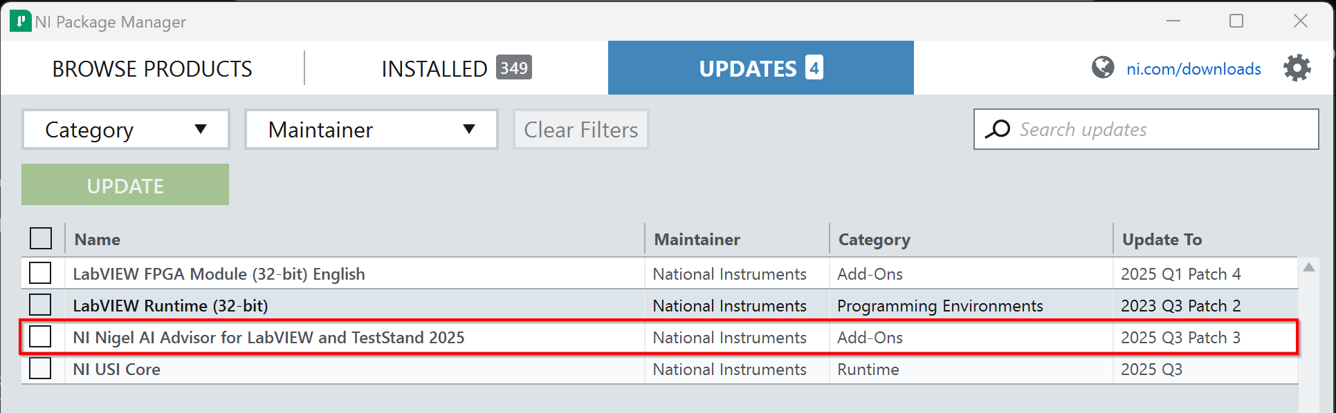

NI Nigel AI is updated separately from LabVIEW and TestStand. The newest versions of LabVIEW or TestStand may not have the newest version of Nigel. Many log in issues with the NI Nigel AI can be resolved by updating.
Please note that your NI Package Manager must be up to date beforehand.
To update Nigel use the Updates tab.

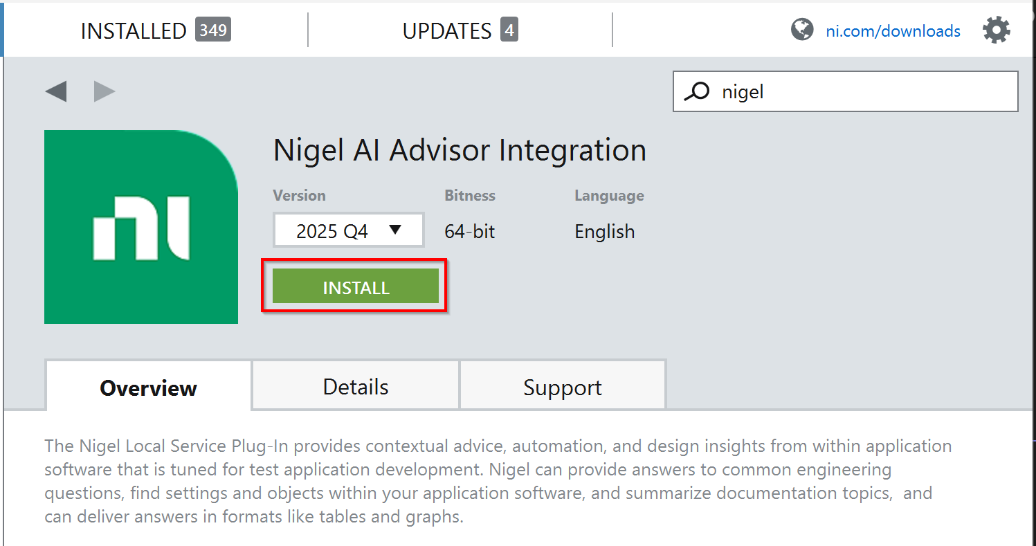

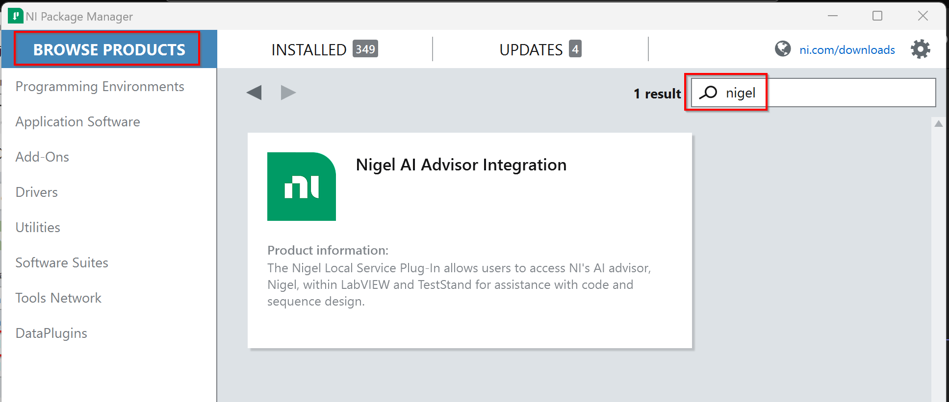

If Nigel doesn't appear in the updates or you want to check for a newer version, you can update manually. Go to Browse Products.  Use the Search Bar and look for "Nigel." Nigel AI Integration should be the first item to appear.  In some cases, you may also see Nigel Local Service Plug-In
After selecting the Nigel AI Integration, select Install to install the patch.
