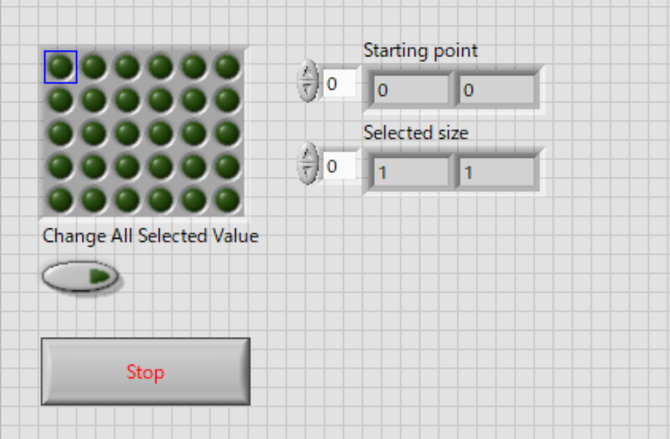

Step 1. Set Up the Front Panel
  1. Create a 2D array of Boolean controls on the front panel.
  2. Ensure the array is initialized with default values, either False or True.

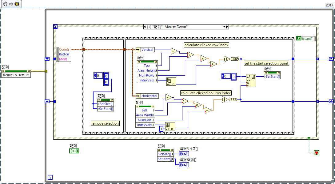

  1. Mouse Down
    - This event is triggered when you click on a Boolean control.
    - This event mainly captures the starting index of the selection, row and column.
    - The index is being stored in the shift registers.

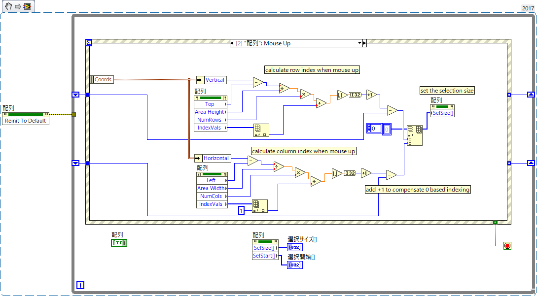

  2. Mouse Up
    - This event is triggered when you release the mouse click.
    - This event captures the ending index of the selection and calculate the selected range.
    - The index is being stored in shift registers.

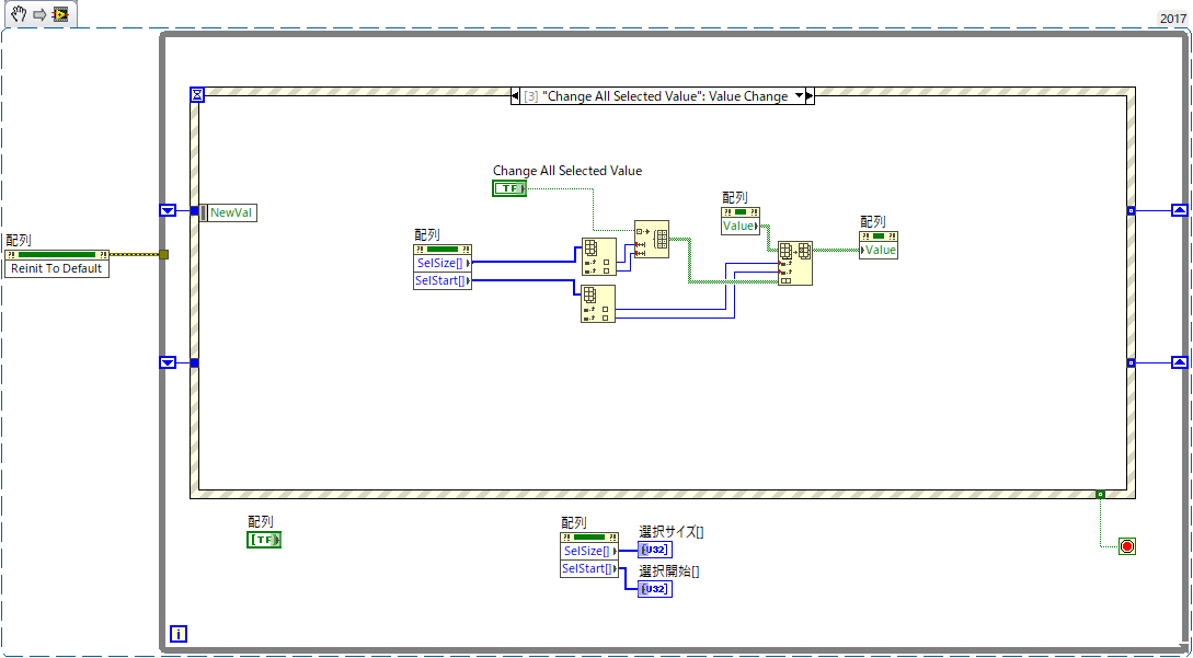

  3. Change All Selected Value
    - This event is triggered by a separate control on the front panel (e.g. a "Change All Selected Value" button).
    - Uses the stored start and end indices from the previous two events to define the selection range.
    - Uses the Initialize Array and Replace Array Subset functions to update all values in the selected range
         - If the first clicked value was True, set all to False.
         - If it was False, set all to True.
