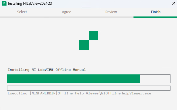

I may encounter one or more of the following symptoms.
During LabVIEW installation
  • The installation hangs during the first launch of the NI Offline Help Viewer.
  • The LabVIEW installer splash screen becomes stuck at “Installing NI LabVIEW Offline Manual / NI Offline Help Viewer.”
  • Multiple NIOfflineHelpViewer.exe processes appear in Windows Task Manager. This occurs during both interactive and silent installations.

Scenario 1: Installation Hangs (First Launch of Offline Help Viewer)
1. Terminate NIOfflineHelpViewer.exe
  1. Open Windows Task Manager.
  2. Select the Processes tab.
  3. Locate NI Offline Help Viewer.
  4. Right-click the process and select End Task.
  5. Select the Details tab.
  6. Verify that no instances of NIOfflineHelpViewer.exe are running.
  7. If any remain, right-click the process and select End process tree.
2. Remove Corrupted Offline Help Database
  1. Delete the following file:
    C:\ProgramData\National Instruments\Offline Help Viewer\database-orm\offline.sqlite
  2. Restart the LabVIEW installation.
