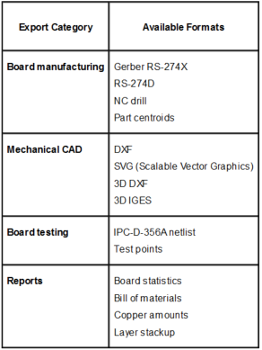

Is it possible to export data in formats such as .cad, .tgz, .gen, .fatf, .asc, etc. from Ultiboard?
Unfortunately, exporting data to .cad, .tgz, .gen, .fatf, and .asc file formats is not supported as Ultiboard only handles the formats mentioned in the Ultiboard help (Help>>Ultiboard help) as shown below.
