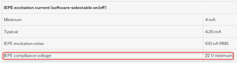

  • The compliance voltage provided in specification sheet is stated as minimum. What is the maximum compliance voltage?
Minimum Compliance Voltage
The minimum voltage provided in the specification sheet is the minimum voltage that IEPE sensor must met as excitation voltage to be under IEPE compliance voltage range. Therefore, it is better to assume the IEPE compliance voltage provided in the specification sheet as maximum value from NI device's perspectives. If the maximum excitation voltage for IEPE sensor is beyond the IEPE compliance voltage, then the supported value is between IEPE minimum excitation voltage to IEPE compliance voltage. Please refer to the example below.
Example:
  • NI Card's IEPE compliance voltage = 22 V minimum
  • IEPE Minimum Excitation Voltage= 5 V
  • IEPE Maximum Excitation Voltage = 25 V
  • Supported Excitation Voltage = 5 V to 22 V
If the IEPE sensor consumes excitation voltage more than IEPE compliance voltage, it is recommended to lower your measuring scale to lower your maximum excitation voltage needed. On the other hand, you can also consider using NI module with higher IEPE compliance voltage or IEPE sensor with lower excitation voltage.
The IEPE Compliance range will be included together in the specification and the minimum value is usually 0V. Please refer your device's specification for further verification. Please reach out to NI Support if further verification is needed.
