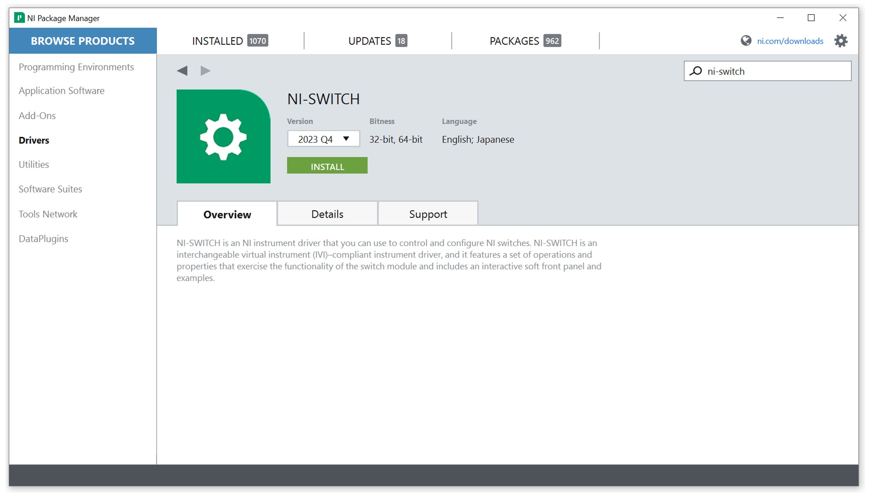

In NI Package Manager, go to the Browse Products Page. In the search field, search for NI-SWITCH, NI-DMM or NI-SCOPE. Choose a version. Only choose one the following versions:
NI-DMM2022 Q3 or newer
NI-SCOPE2022 Q3 or newer
NI-SWITCH2022 Q4 or newer
Click INSTALL.

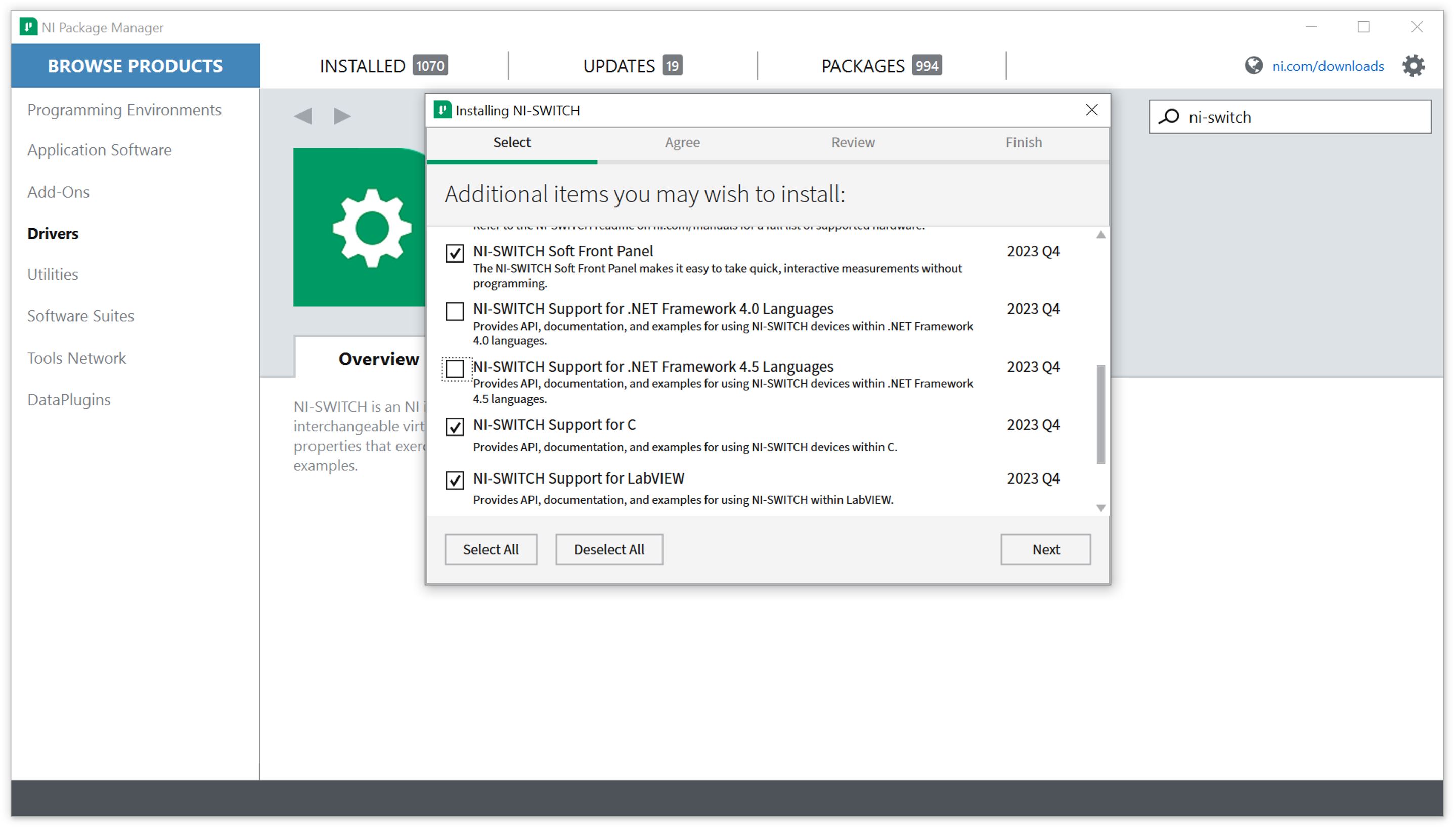

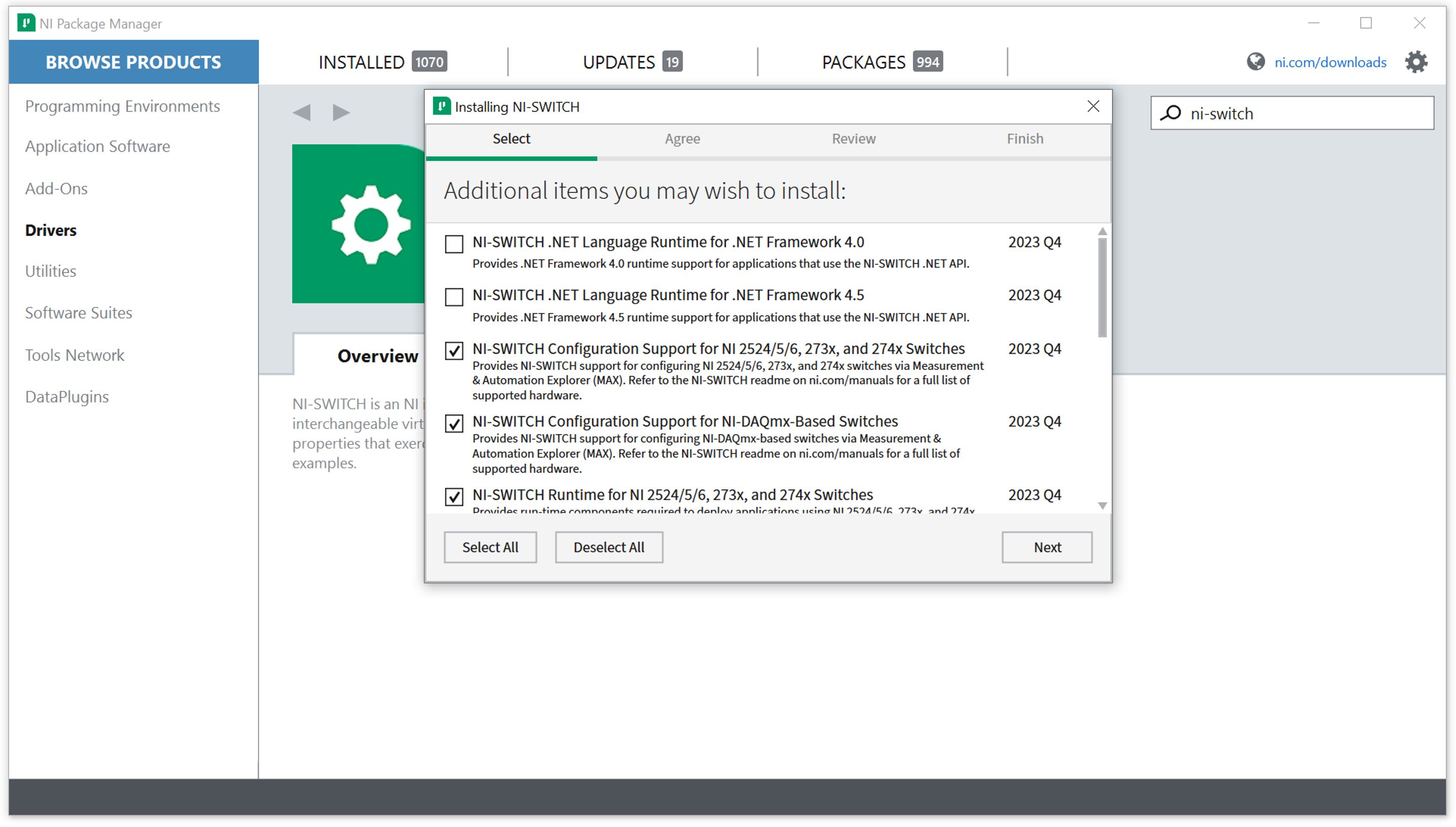

A pop-up window titled Installing NI-SWITCH opens. In there, you can choose Additional items you may wish to install. Deselect the following entries:
  • NI-SWITCH .NET Language Runtime for .NET Framework 4.0
  • NI-SWITCH .NET Language Runtime for .NET Framework 4.5
  • NI-SWITCH Support for .NET Framework 4.0 Languages
  • NI-SWITCH Support for .NET Framework 4.5 Languages
03_NIPM-DESELECT-2.JPGChoose Next. Go through the following steps of the installation as usual (you don’t have to make any more changes).
