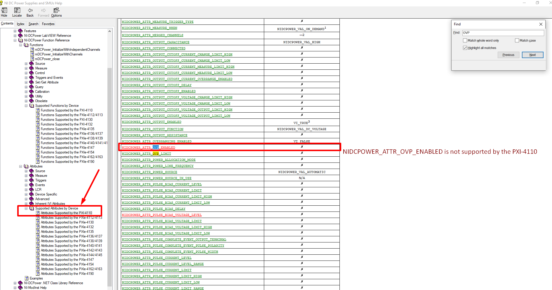

When setting up a power supply or a source measure unit (SMU) or programming with NI-DCPower in LabVIEW or LabWindows™/CVI, I get Error -1074135023: IVI: Function or method not supported. For example, if I try to enable the attribute NIDCPOWER_ATTR_OVP_ENABLED on a PXI-4110, I get the error below.
This error shows up because your hardware does not support setting the attribute, function, method, or value that you are trying to configure using NI-DCPower.
You can verify the Functions and the Attributes supported by your Device by opening the driver's help page: Help » NI DC Power Supplies and SMUs Help, then navigating to either one of these paths:
  • Programming with NI-DCPower » NI-DCPower Function Reference » Functions » Supported Functions by Device.
  • NI-DCPower » NI-DCPower Function Reference » Attributes » Supported Attributes by Device.
For example, you can confirm that the PXI-4110 does not support enabling the NIDCPOWER_ATTR_OVP_ENABLED attribute.
If you confirm that the property is supported by the hardware, try resetting the NI Database using the Hardware Configuration Utility to rule out any database corruption or inconsistent configuration state.
