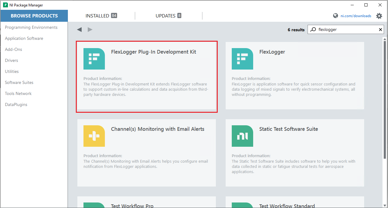

  1. To access FlexLogger Plug-in template in LabVIEW, you need to install FlexLogger Plugin Development Kit. Launch NI Package Manager and search for FlexLogger Plugin Development Kit.
    1. Check FlexLogger Plug-in Development Kit Compatibility with FlexLogger and LabVIEW.
  1. Select and INSTALL the FlexLogger Plugin Development Kit version that is compatible with your FlexLogger and LabVIEW version.
  1. Follow the pop-up windows instructions to complete the installation.

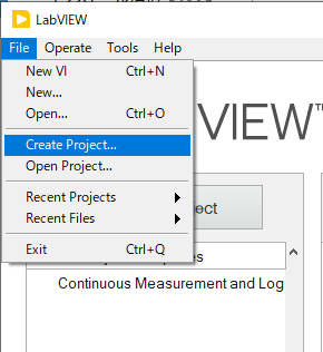

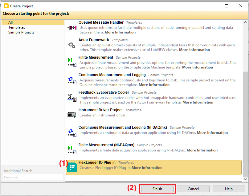

  2. Launch LabVIEW.
  3. In LabVIEW, click File >> create project .

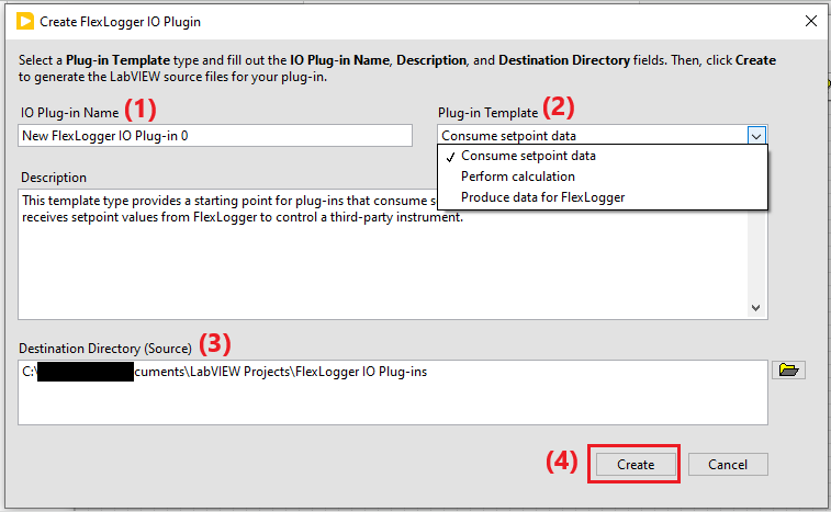

  1. From the Create Project window, select FlexLogger IO Plug-in and click Finish.
  1.  In the Create FlexLogger IO Plug-in window, update the IO Plug-in Name and select a Plug-in Template based on your goal.
  2. (Optional) Update the Description and Destination Directory (Source) for the plug-in.
    By default, the wizard saves new plug-ins in My Documents\LabVIEW Projects\FlexLogger IO Plug-ins\ directory
    1. Click Create

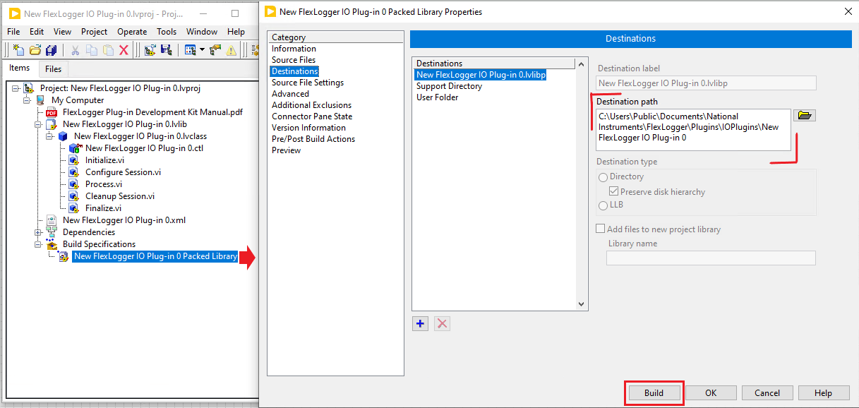

  1.  (Optional) Customize your plug-in using the methods described in the Plug-in Development section here .
  2.  Expand Build specifications, click Build.

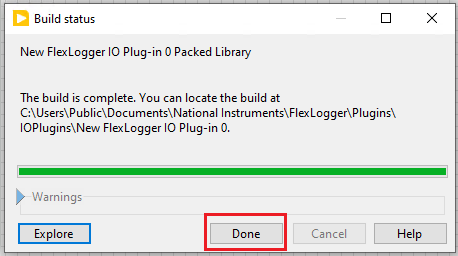

  1. Once the build is complete, click Done .

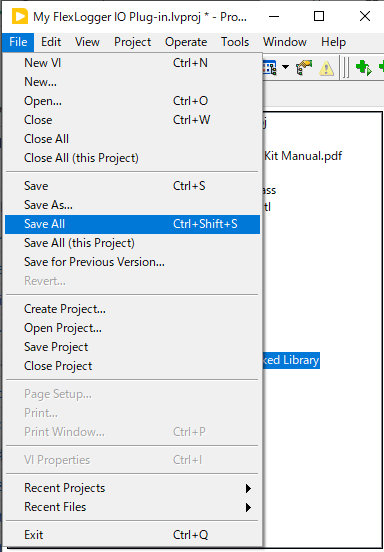

  1. In the Project Explorer window, select  File>>Save All to save your project.

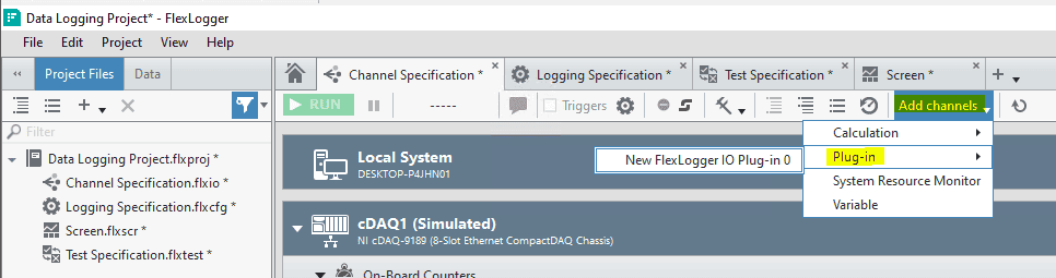

After the build, a folder containing the plugin's packed library and XML files will be generated in the "Destination path" specified above. FlexLogger loads plugins from this folder on startup.
The created Plugin can be checked in FlexLogger Channel Specifications tab from Add Channel >> Plug-in . If the newly created Plugin is not displayed, restart FlexLogger.
