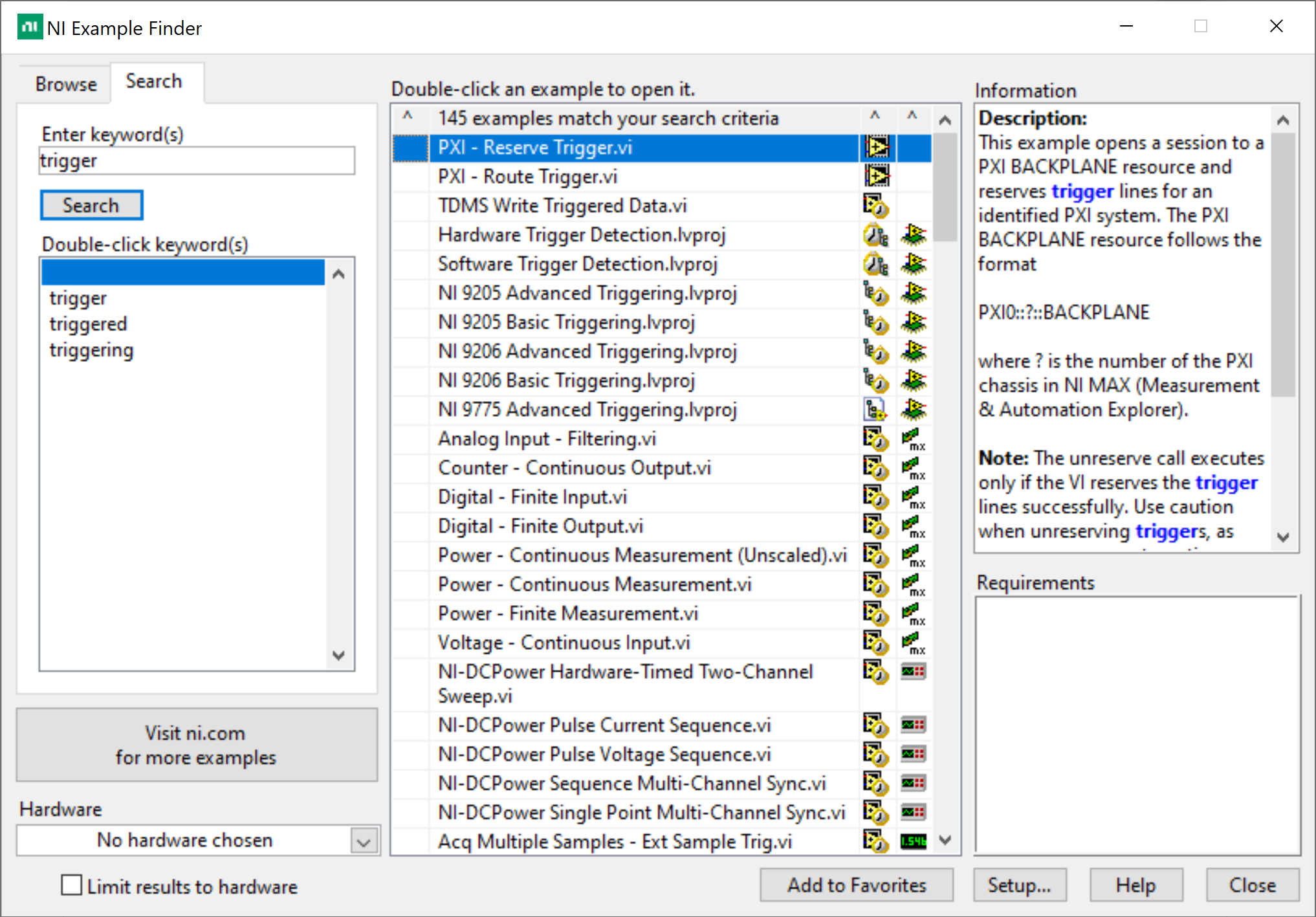

LabVIEW example for PXI trigger reserve could be found at:
For 32-bit LabVIEW:
C:\Program Files (x86)\National Instruments\<LabVIEW Version>\examples\Instrument IO\VISA\PXI\PXI - Reserve Trigger.vi
For 64-bit LabVIEW:
C:\Program Files\National Instruments\<LabVIEW Version>\examples\Instrument IO\VISA\PXI\PXI - Reserve Trigger.vi
or
Using the NI Example Finder as below:
