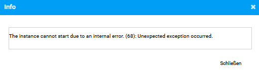

I cannot initialize the DataFinder in SystemLink. The following error message is shown:
"The instance cannot start due to an internal error (68): Unexpected exception occurred."
This issue might occur if the DataFinder database (index) is broken, which can happen if the power supply is suddenly switched off while the DataFinder is saving data.
This can be also a symptom of a very long query to reach the database, causing a closing of the connection.
