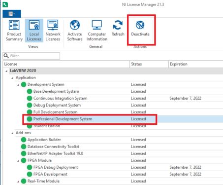

For example, if you have LabVIEW Full Development System 2020 and LabVIEW Professional Development System 2020 installed on your computer and you wish to access the Full Development System, you need to open NI License Manager and
  • in case of a Single-Seat license, under the "Local Licenses" tab click on LabVIEW Professional Development System, and on the top click on "Deactivate" (Figure1).
Figure 1

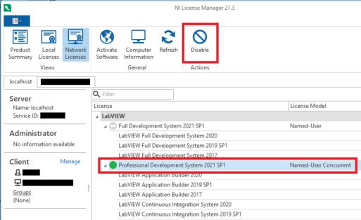

  • in case of a Multi-Seat license, under the "Network Licenses" tab click on LabVIEW Professional Development System, and on the top click on "Disable" (Figure 2).
Figure 2
Note: In case of a Multi-Seat License, deactivating a certain Development System will deactivate all its components listed.
