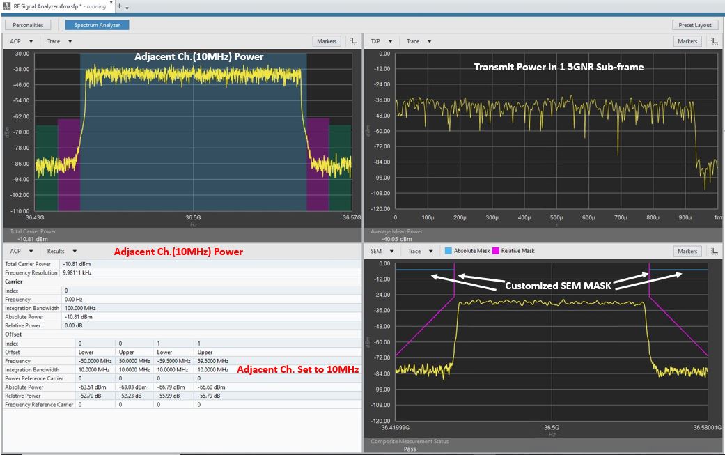

The results shown in Steps are only some measuring examples of the configured and generated waveform in RFmx Waveform Creator. Users can reconfigure the waveform in RFmx Waveform Creator and adjust the settings in RF Signal Analyzer to have different measuring results.
Refer to below two screenshots for examples.
  1. The first example of Signal Analysis of 5G NR at 36.5GHz with RFmx default settings.Result_Signal A_2.jpg
  2. The second example of Spectrum Analysis of 5G NR at 36.5GHz with customized RFmx settings (such as customizing the Adjacent Channel Bandwidth to 10MHz, customized Spurious Emission Mask). Result_Spectrum A_2.jpg
