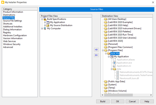

  1. Create an Installer Build Specification. For that, right click on Build Specifications and choose New >> Installer.
  2. In the Destinations category, you can create new folders on the target system and configure where your application will be installed.KB 6.png
  3. In the Source Files category, move your application to the Destination View.KB 7.png

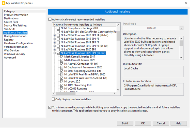

  4. In the Additional Installers category verify that the NI LabVIEW Run-Time Engine is selected. Deselect Automatically select recommended Installers as well as Only display runtime installers, you can also select additional software to be contained together in the installer.KB 8.png
  5. Configure some other properties, click Build to create the installer.

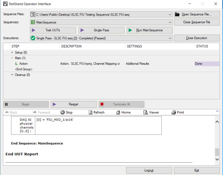

Installing and Running Sequence on Test System
Copy the built installer to the ECUTS Test System, and execute it to install.
After installation, find TestExec.exe, click and launch Operator Interface, then you can run the testing sequence.
