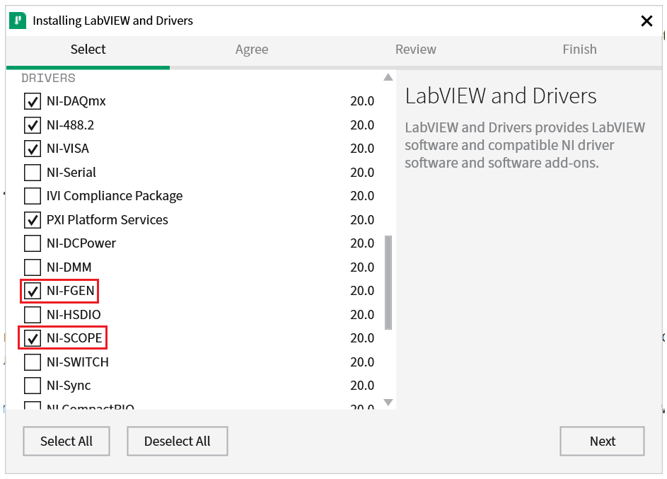

  • For LabVIEW 2019 to LabVIEW 2021
While installing LabVIEW, please make sure that either NI SCOPE or NI FGEN is selected before launching the installation, as shown below:                                 image.png

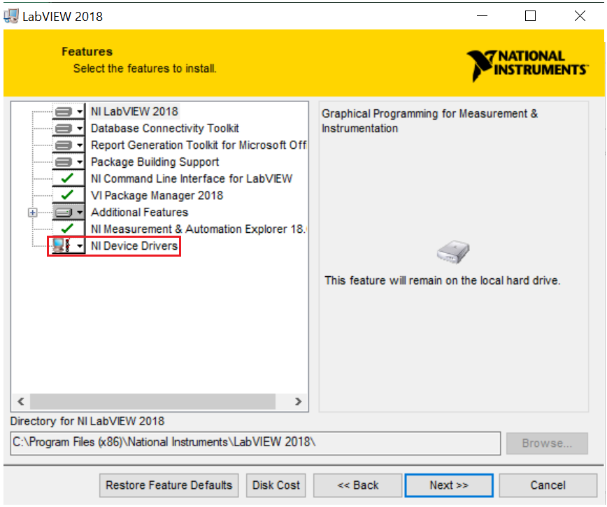

  • For LabVIEW 2018 and earlier versions
While installing LabVIEW, please make sure that the option NI Device Drivers is selected before launching the installation, as shown below:

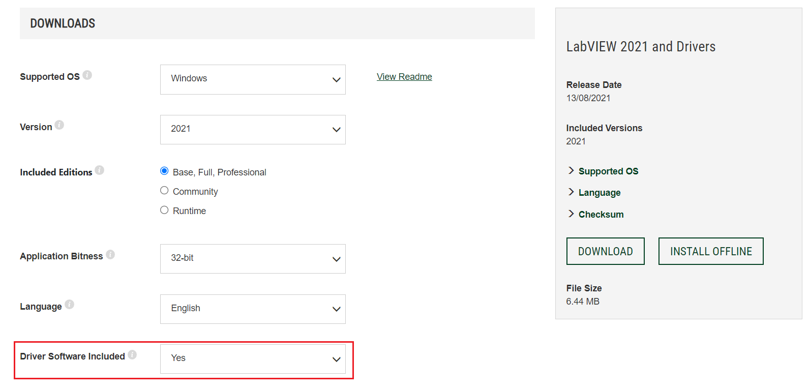

  • For LabVIEW installation using the offline installer
Before downloading the offline installer of LabVIEW, please make sure that Yes is selected for the option Driver Software Included, as shown below:
Note:
If LabVIEW was already installed without NI SCOPE or NI FGEN, NI-HWS will be available by installing one of them.
The last version of NI SCOPE or NI FGEN that includes NI-HWS is 21.0 that is compatible only with LabVIEW 2021.
