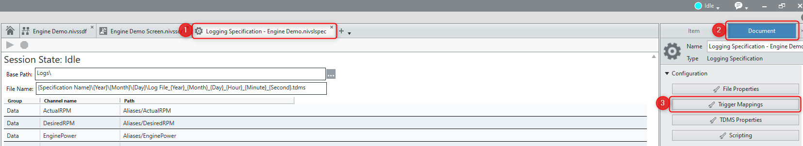

1. Navigate to your logging specification and then in the right-hand pane select the Document tab. From here, select the Trigger Mappings button.

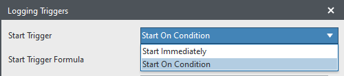

2. Set the Start Trigger field to Start on Condition

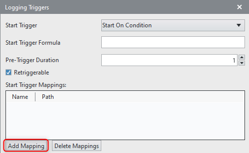

3. Before we can define the Start Trigger Formula, we need to add some variables which we will use to define the condition the triggering should start. to do this, click the Add Mappings button in the Start Trigger Mappings section:

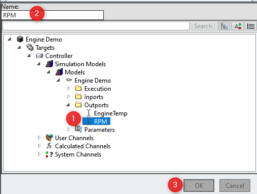

4. Enter a channel to add as a variable to be used for the trigger logic and give this channel/variable a name. for example you can add the Targets\Controller\Simulation Models\Models\Engine Demo\Outports\RPM channel and give the variable a descriptive name, such as RPM:
5. Once you have added all of the channels you will use to determine your trigger logic, you can add this logic to the Start Trigger Formula section. This section must evaluate to either true or false. One example would be: RPM > 5000
This formula would evaluate to true whenever the Targets\Controller\Simulation Models\Models\Engine Demo\Outports\RPM channel, which we mapped to a variable named RPM is over 5000, triggering the logging specification to start logging (assuming the logging session has been started).
