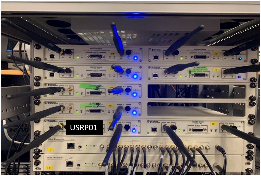

  1. Name the device in NI-MAX correctly, refer to MIMO_Application_Framework_Manual_ver_19.5 for details
          Make sure USRP01 is named to the right device which is located at left bottom. Shown in below:

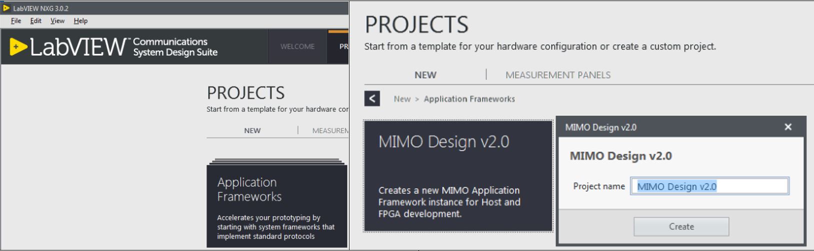

  1. Launch LabVIEW Communications System Design Suite 2.0 by selecting LabVIEW Communications 2.0 from the Start menu (depends on which version installed), then click on Application Frameworks
  2. Select MIMO Design v2.0 (depends on which version installed) and name in Project name and Create the project

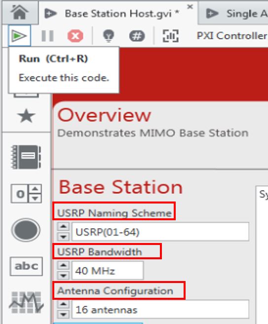

  3. Within that project created in step 3, open Base Station Host.gvi
  4. Configure the base station for USRP Naming Scheme, USRP Bandwidth which is the device supported bandwidth such as 40 MHz or 120 MHz, Antenna Configuration. Leave other fields as defaultName BS Project.JPG
  1. Click run (Ctrl + R) and wait for base station to be active

  2. Similar to create base station project, Launch LabVIEW Communications System Design Suite 2.0 by selecting LabVIEW Communications 2.0 from the Start menu (depends on which version installed), then click on Application Frameworks
  3. Select MIMO Design v2.0 (depends on which version installed) and name in Project name and Create the project

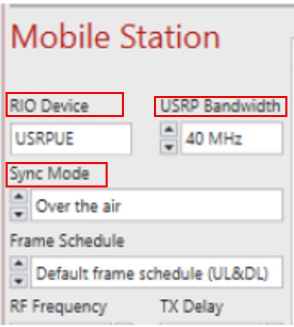

  4. Within that project created in step 3, open Single Antenna Mobile Station Host.gvi
  5. Configure the mobile station for RIO Device to USRPUE which is named in NI-MAX, USRP Bandwidth which is the device supported bandwidth such as 40 MHz,120 MHz or 160 MHz, Sync mode to Over the air. Leave other fields as default
  6. Click run (Ctrl + R) and wait for mobile stations to be ready

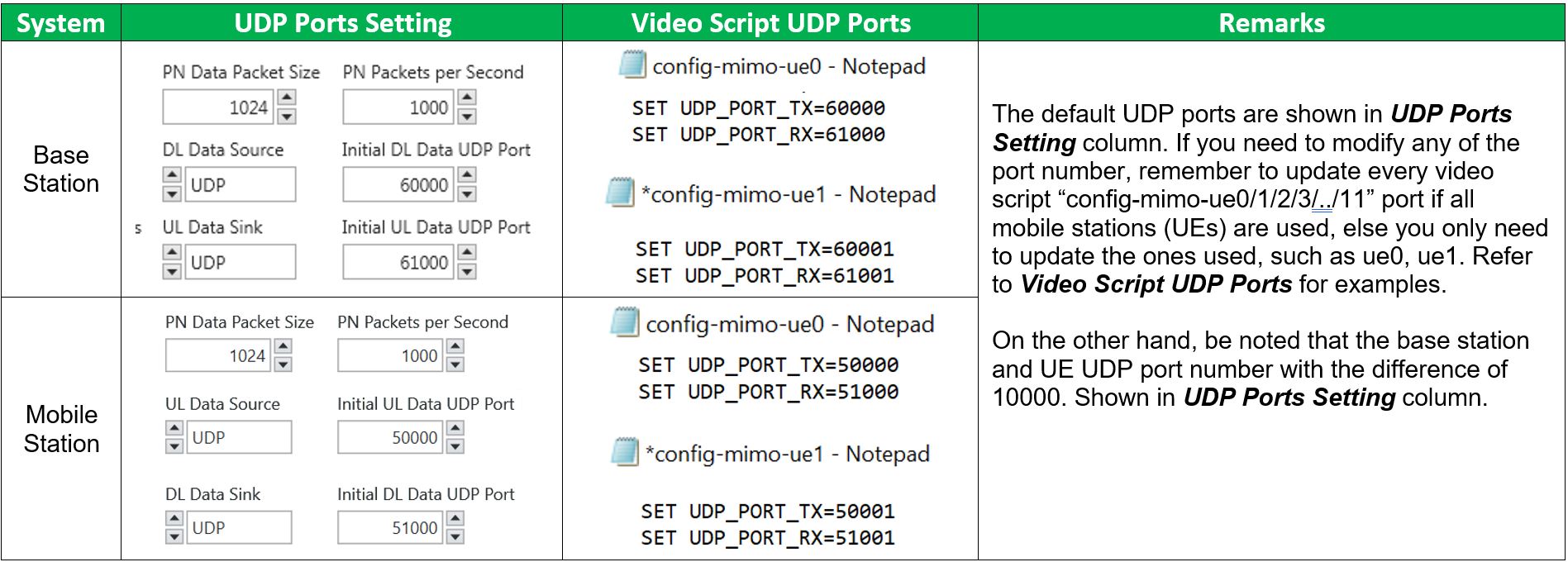

Set UP UDP Ports
  1. Set base station Initial DL data UDP Port 10000 higher than mobile station Initial UL data UDP Port, and base station Initial UL data UDP Port 10000 higher than mobile station Initial DL data UDP Port
  2. Check and edit the configure-mimo-ue# (ue# from ue0 to ue11) scripts to match the UDP ports, summarized in below table:UDP Ports.JPG
