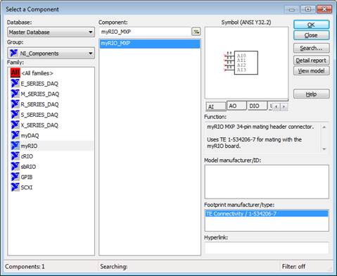

  1. Select Place » Component from the menu bar. This will open the component browser.
  2. Choose the following parameters as displayed in figure 3.
Database: Master Database
Group: NI_Components
Family: myRIO
Component: myRIO_MXP
This provides access to the NI myRIO connector.
Figure 3 – NI myRIO Component Database
  1. With the NI myRIO_MXP selected, click OK.

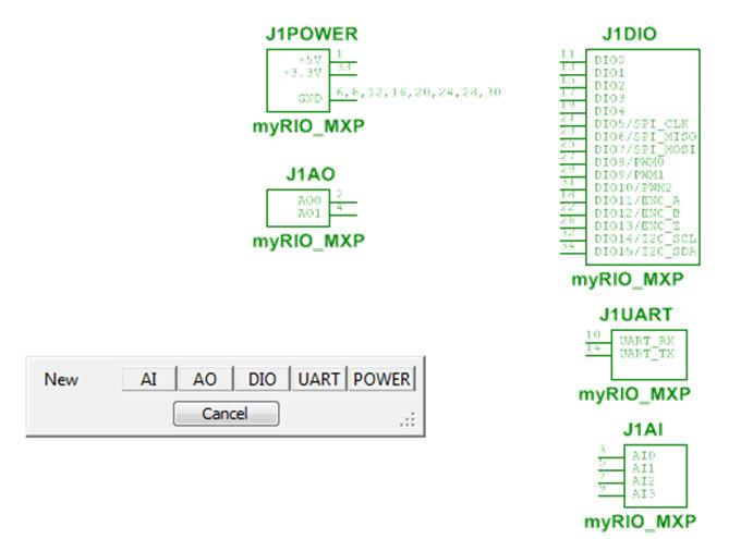

  1. The NI myRIO connector is a multi-section component allowing the student to place the IO sections on the schematic they will be using. Select the sections that are planned to be use:
               AI – Analog input channels
               AO – Analog output channels
               DIO – Digital input and output channels
               UART – Serial communication channels
               POWER – Power supply channels
Note – The NI myRIO has two MXP connectors so up to two of these multi-section components can be placed on a schematic for use with a single NI myRIO.
Figure 4 shows the section selector pane and the sections placed on the schematic.
Figure 4 – Multi-section component for NI myRIO MXP connector

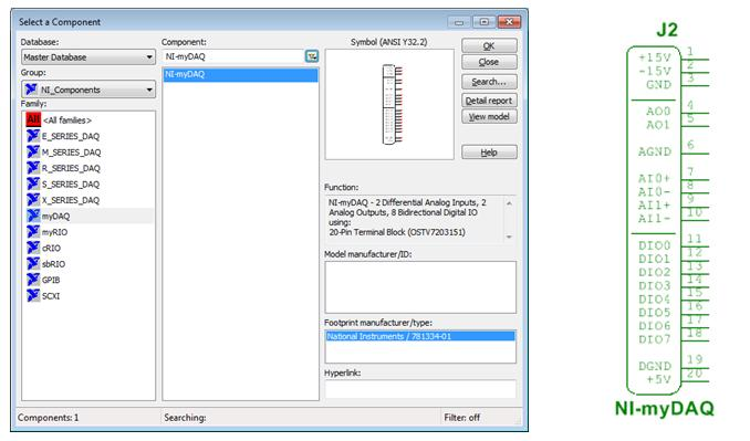

The NI myRIO also has a mini system port (MSP) this is the same as used on the NI myDAQ so the students can use the NI myDAQ connector to gain access to this IO.
Family: myDAQ
Component: NI-myDAQ
The NI myDAQ connector component can be seen in Figure 5.
Figure 5 -Selection and placement of the myDAQ connector for using the mini-system (MSP) port on the NI myRIO
