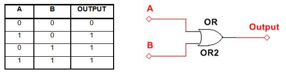

OR
Boolean Expression: A'B+AB'+AB

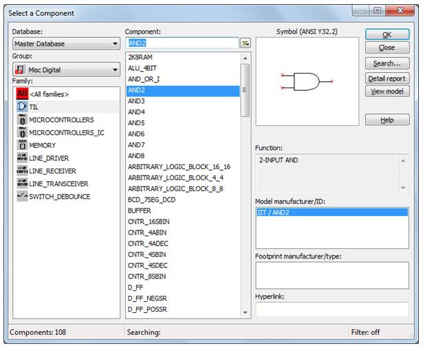

  2. Place down a two input AND gate from the component database. Right click and select Place Component. Choose the following parameters:
                                            Database: Master Database
                                            Group: Misc Digital
                                            Family: TIL
                                            Component: AND2
  1. Place the component on the schematic.

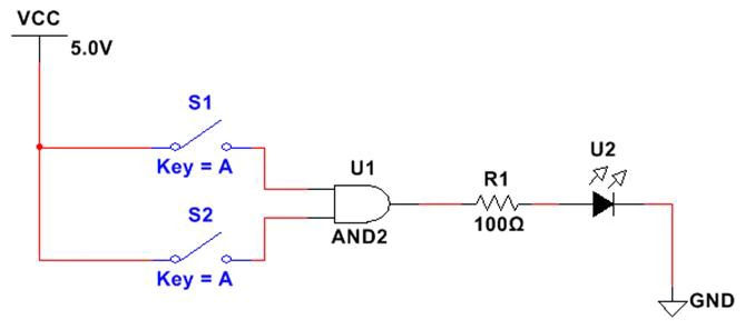

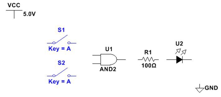

  1. In order to evaluate the behaviour of the component we will use a virtual switch and LED. Place the following components on the schematic.

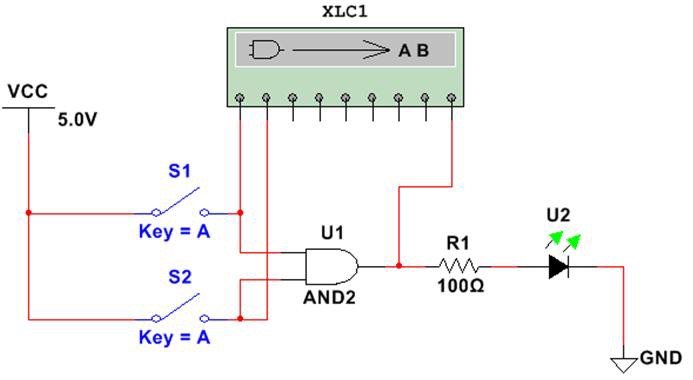

  1. Arrange the components on the schematic as below:
  1. Wire the components together to create the digital logic circuit
  1. Once we have completed our schematic we can evaluate the operation of the AND gate. The two switches and the LED are interactive components. Click Run on the tool bar shown below.

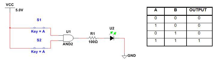

  1. During execution toggle the switches and view the effect on the LED. The AND gate should respond according to the truth table below. When both switches are closed (high), the LED turns on. This allows the student to experiment with the switches to understand the AND gate operation.

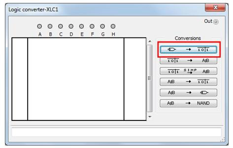

  1. Multisim also includes interactive instruments that we can connect to our schematic, as we would benchtop instruments. In understanding digital logic the Logic Converter is a powerful tool. The Logic converter allows us to obtain a truth table and Boolean expression for our circuit. Place a Logic Converter onto the schematic.
  1. Connect the Logic Converter to the schematic as shown below. The Logic Converter allows multiple inputs with and a single output.
  1. Double click the Logic Converter to open its user interface.
  2. Click on the top conversion button as shown below. This is will analyze the schematic and create a truth table for the response.
  1. Click on the next conversion button. This analyses the truth table and generates the Boolean expression. For an AND gate, the Boolean expression should be AB. The logic converter also allows students to input truth tables and Boolean expressions and generate logic diagrams.

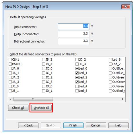

  1. Create a new PLD schematic for your Digilent board. Details of this process can be found within the Getting Started with Digilent Boards in Multisim. During the creation choose to Uncheck all when selecting the IO terminals to include on the schematic.

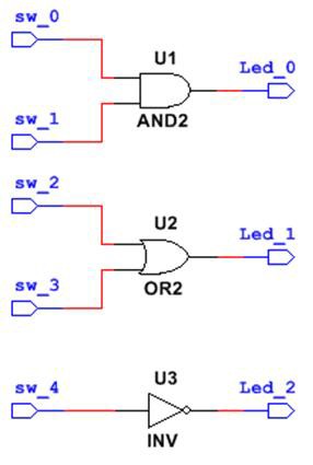

  1. In this tutorial we are going to create an example that allows students to gain an understanding of the functionality of OR, AND and NOT logic gates. To add IO to the schematic, select either the input or output connector from the PLD toolbar. Click the input connector button.
  1. This will display the input connector dialog and provide a list of all the IO on the Digilent board that has been designated as an input. From the list select switch 0 (sw_0) and click OK. Place the terminal on the schematic.
  1. Repeat the process to add an input for switch 1 (sw_1).
  1. Using the output connector button, create an output terminal for LED 0 (LED_0).
  1. Open the Component Database (Right click > Place component), and place a 2 input AND gate.
                                            Group: PLD Logic
                                            Family: LOGIC_GATES
                                            Component: AND2
  1. Repeat this process to add inputs, outputs, and logic gates to demonstrate the OR and NOT gates. This will create a schematic similar to the image below.

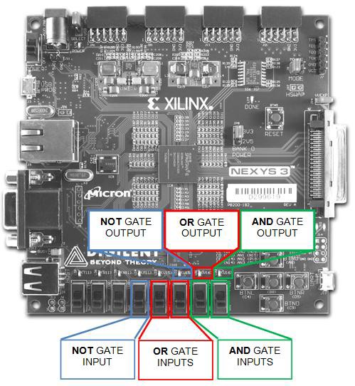

  1. Once the schematic has been created, we are ready to deploy the logic schematic to the Digilent board so students can physically manipulate the switches and view the response on the LEDs. Full details on deploying to Digilent cards can be found in the Getting Started with Digilent Boards in Multisim. Select: Transfer » Export to PLD from the menu bar. Here you will see the three export options. We want to export to physical hardware so select Program the Connected PLD. Click Next.
  2. Choose the Xilinx tool to compile the Multisim PLD design to a programming file. If you installed the Xilinx ISE Tools to the default location, they should autopopulate. If not, click the Xilinx tool drop-down menu, select Manually select tool, and then browse to the file folder where the tools were installed. The Xilinx user constraint file contains directions that map the connectors in Multisim to the pins of the Xilinx FPGA, Part Number XC6SLX16.
  3. At this point, you must connect the Digilent board to your computer. To check if all requirements have been met and the device is properly connected to Multisim, click the Refresh button. If the board is detected, the Device status displays Detected - Date and Time, as shown below.
  1. To proceed, click Finish. This begins the 11-step process of programming the PLD. Multisim automatically invokes the Xilinx ISE Tools (Creates the Xilinx project, Checks syntax, Translates, Places & Routes, Generates the programming file, and so on).
  2. Once the code had been generated and deployed to the Digilent board, the student can switch the switches and view the response on the integrated LEDs.
