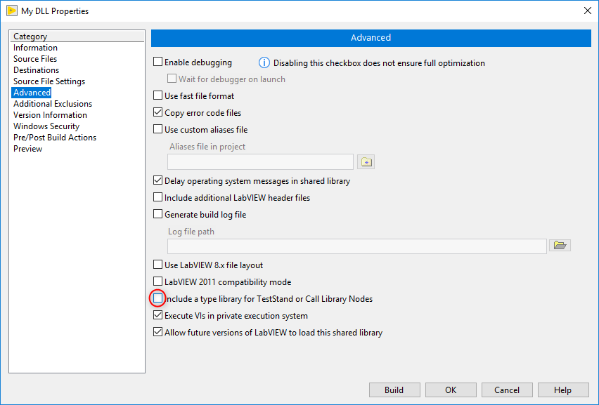

問題敘述
我試圖從我的LabVIEW專案(Project)中建立一個新的DLL,所有VI都是正常運作的,但是當我按下Build按鈕時,會出現以下錯誤:
Error 1 occurred at : Compile Dll Stub.vi ->
AB_Engine_DLL_Build_Stub.vi
Possible reason(s):LabVIEW:(Hex 0x1) An input parameter is invalid. For example if the input is a path, the path might contain a character not allowed by the OS such as ? or @.
Command requires GPIB Controller to be Controller-In-Charge.
我要如何才能解決這個問題?
解決方案
在Build Specification中,您必須選擇「Advanced」項目,且需要取消勾選「Include a type library for TestStand or Call Library Nodes」。
