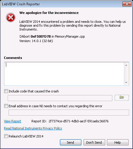

I am using NI-DCPower driver in my TestStand sequence and it crashes with the error message:
DAbort 0xF50EFD7B in MemoryManager.cpp.
To fix this issue, you have 2 steps you need to follow in the right order:
  1. Make sure you have the right NI-DCPower version using NI-DCPower and LabVIEW Compatibility
  2. Make sure your seach directories in TestStand are pointing to the relevant driver folder for NI-DCPower.
