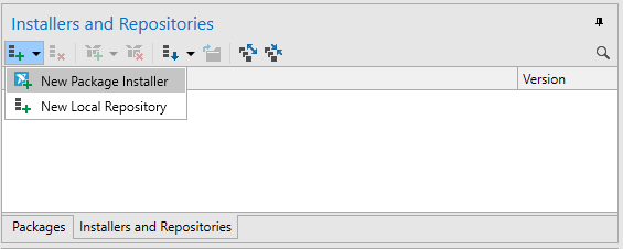

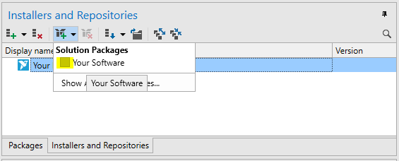

Your Software will now expect all three packages to be installed. If the client desktop system has NI Package Manager installed and is connected to the internet, it will typically find these sources through standard feeds.
If you want them to be part of your feed or your installer, you will have to add them. See in the
Additional Information section for a step-to-step-tutorial.
