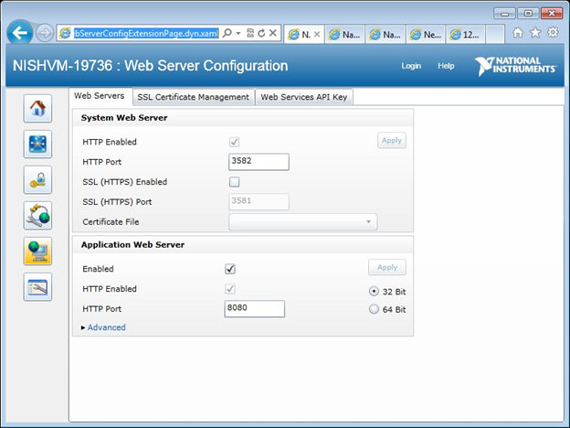

Web-Based Configuration
  • You can click the Configure Web Application Server button in the web server options page, shown above, to open the Web-based Configuration & Monitoring utility in a web browser. It is recommended to use Internet Explorer.
  • Another way to open this utility is to right-click the Web Service project item in the project tree within LabVIEW and select Application Web Server»Manage Web Server.
  • Click the Web Server Configuration button on the left-hand sidebar to configure the  Application Web Server and System Web Server.
  • Click the Web Services Management button on the left-hand sidebar. Any published Web Services appear in the Deployed Web Services list. You might need to click the Refresh button to update the list.
