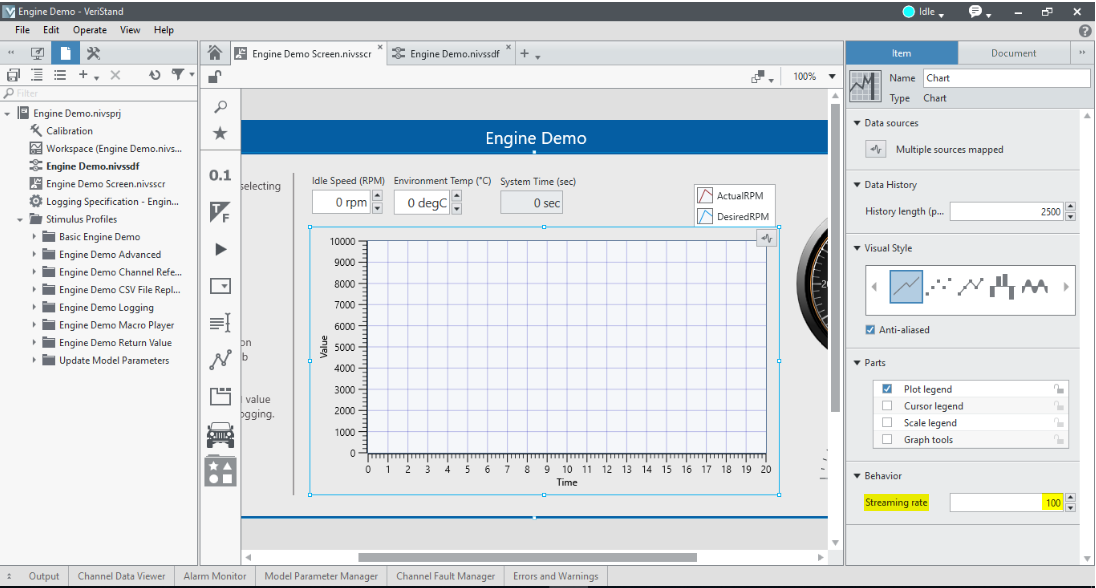

I'm running a simple Sine wave generation model in NI VeriStand. When I visualize the waveform on NI VeriStand UI Manager, I always see only 100 data points per second, irrespective of how fast I'm trying to run my Model. Why is that the case?
The streaming rate for Chart indicator in NI VeriStand UI Manager is set to 100 by default as shown:
You can change the Streaming Rate from Behavior tab to get the required response.
