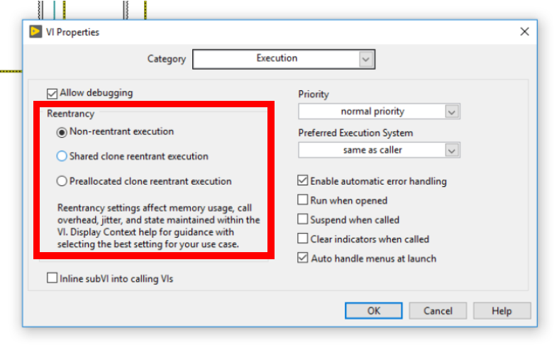

I have multiple copies of the same SubVI which I need to call simultaneously. How can I do this?
When attempting to call two SubVIs simultaneously, there are two aspects to consider: reentrancy and synchronization.
By default, only one copy of a SubVI is open in the computer’s memory at any one time. LabVIEW has two alternative options for re-entrancy: Shared Reentrancy, which starts with only one copy of each SubVI in memory, but adds an additional copy whenever needed; and Pre-allocated Reentrancy, which checks before starting for the maximum number of each SubVI in the code, and allocates that many instances to memory in advance. To assist with deciding which of these options is the best for your application, check the comparison contained in the Reentrancy help page. The Reetrancy settings for a VI can be changed in the Execution page of the VI Properties menu.
