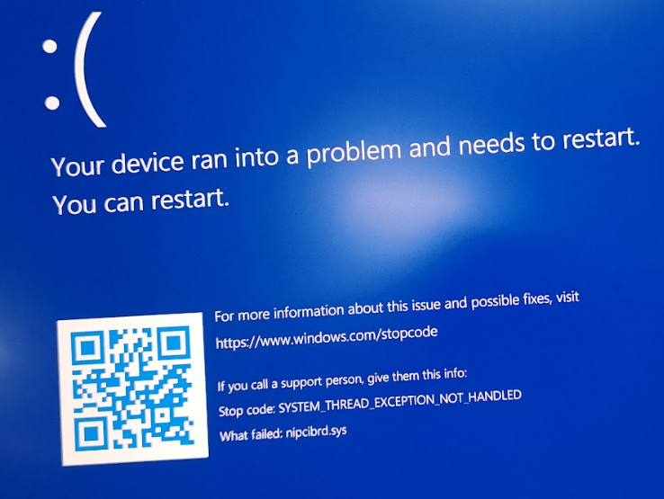

After I install NI software (LabVIEW, NI-DAQmx, NI-488.2, etc.) and restart the PC,I ran into a Blue Screen of Death (BSoD) that contain either one of the below messages.
  • nipcibrd.sys SYSTEM_THREAD_EXCEPTION_NOT_HANDLED
  • nipcibrd.sys SECURE_PCI_CONFIG_SPACE_ACCESS_VIOLATION

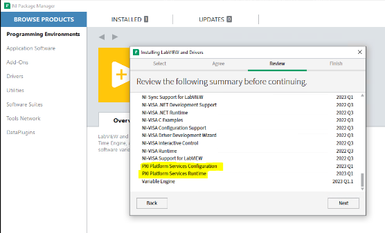

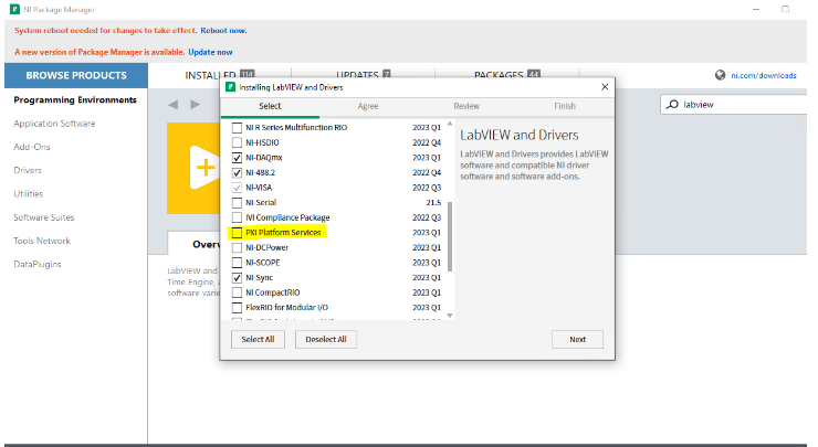

  1. Deselect PXI Platform Services when installing NI software. If the review list includes components with "PXI" in their names, do not reboot your PC after installation is complete, instead click the 「✕」 in the top right corner to cancel the reboot and proceed with the next stpes.

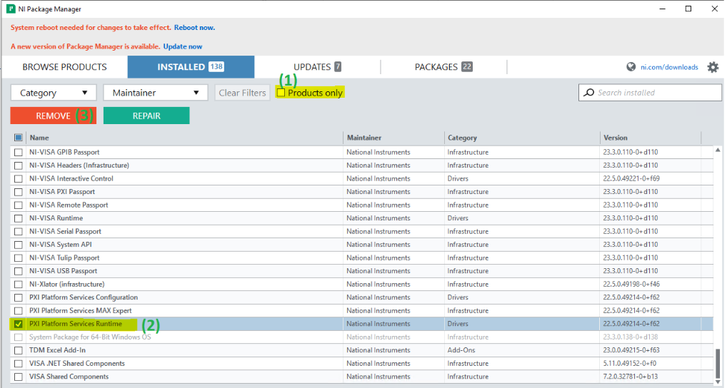

  1. Open NIPM and in the Installed tab, uncheck Products Only.
  2. Check PXI Platform Services Runtime and click Remove.

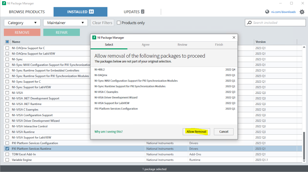

  1. Click Allow Removal in the pop-up window and proceed to complete the uninstallation.

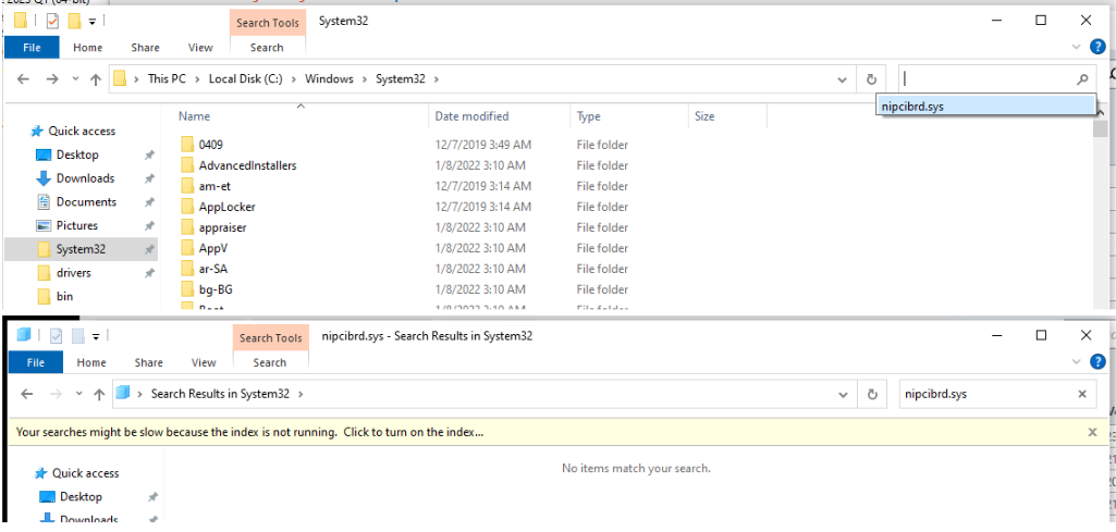

  1. Once the uninstallation is complete, navigate to C:\Windows\System32 and verify that nipcibrd.sys is not present.
  1. Restart your PC.
