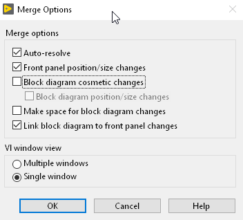

  • LVMerge tool presents with Options such as “block diagram cosmetic changes” (as shown in image below). Are those options pre-settable in an ini file?
  • Are there any command line parameters like the LVCompare.exe can be used to configure LVMerge tool's Options Menu?
Unlike LVCompare.exe, there is no command line parameter available for LVMerge.exe to configure its Option Menu. There is also no INI file can be used to preset the Option menu configuration. The Option menu configuration can only be modified by user manually.
