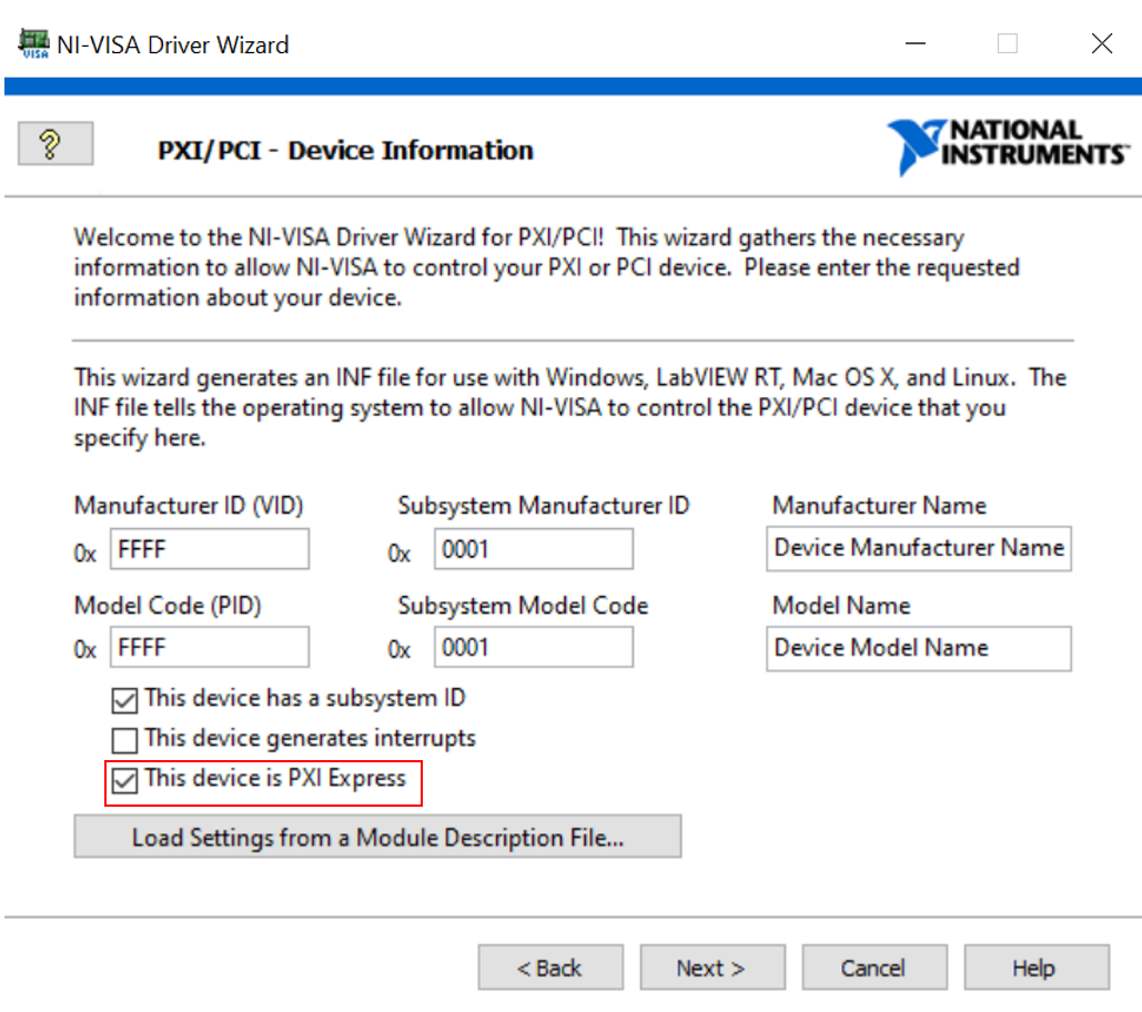

  1. Generate the prerequisite files. Refer to Configuring the NI Real-Time Environment and NI-VISA to Recognize a Third Party Device to generate both a .inf and .ini file.
    1. Input the required information like manufacturer ID, name, etc. Select This Device is PXI ExpressDevice Information.png
    2. Click Next.
    3. Add steps as necessary and then click Next again. For example, a Read access step.
  1. Ensure that files in the form of pmd_linux.ini and prefix.inf file is listed as files to be generated. Example files are attached at the end of this article.
