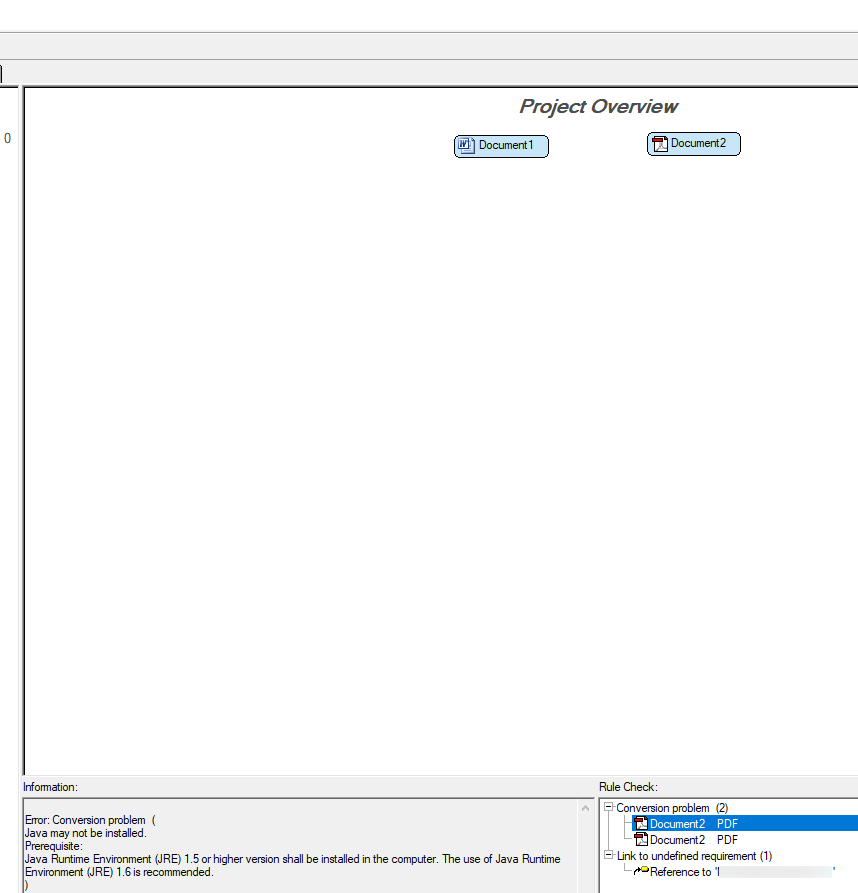

I am using Requirement Gateway and after I add certain document types, such as PDF or Excel,  in the Configuration/Project view, I notice that in the Management View tab and Rule Check section, I see:
Error: Conversion Problem (
Java may not be installed.
Prerequisite:
Java Runtime Environment (JRE) 1.5 or higher version shall be installed in the computer. The use of Java Runtime Environment (JRE) 1.6 is recommended.
This error occurs when Requirements Gateway can not detect a compatible version of JRE.
