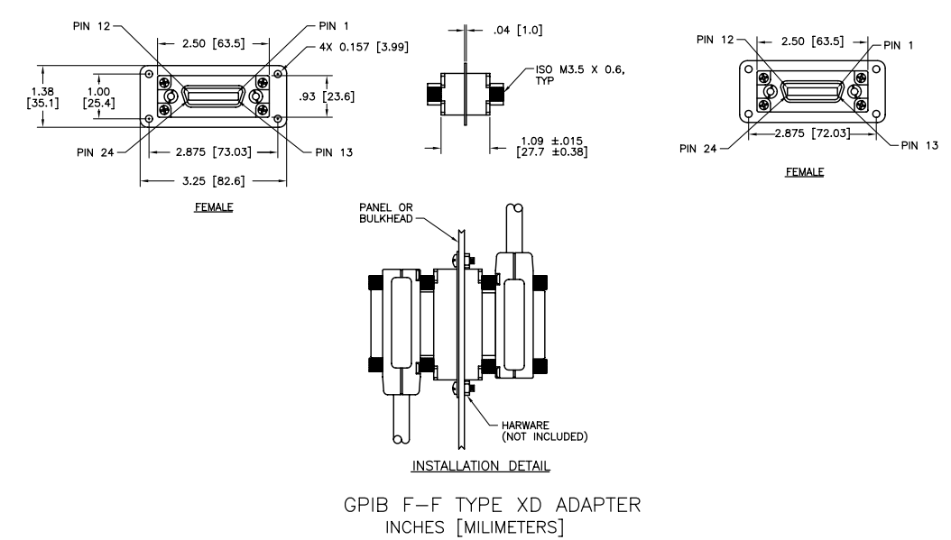

XD
The image below is obtained from GPIB Bulkhead Dimensional Drawings - NI
A picture containing text, diagram, sketch, technical drawing  Description automatically generated
