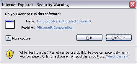

  11. If you have the Silverlight plugin already installed for your broswer, skip to step 12. Otherwise, you will see a screen similar to the one below.
  12. Click the "Install Microsoft Silverlight" button and accept any warning messages from your browser.
  1. Click "Install now" to install the Silerlight plugin.
  2. When the Silverlight installation is complete, you may need to refresh your browser (press F5). The Web Configuration Utility will be loaded as shown below.
