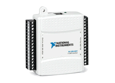

The NI USB-8451 is a high-speed USB-based device used to communicate to serial peripheral interface (SPI) and inter-integrated circuit (I2C) compatible devices such as EEPROMs, real-time clocks, ADC and DAC converters, LCDs, as well as many other electronic devices. The NI USB-8451 includes driver software that provides high level, easy-to-use LabVIEW functions, property nodes, and references. This article will demonstrate how the USB-8451 I2C and SPI interface can be used to evaluate of a Texas Instruments analog-to-digital converter (ADC).

Figure 1NI USB-8451  I2C and SPI Interface

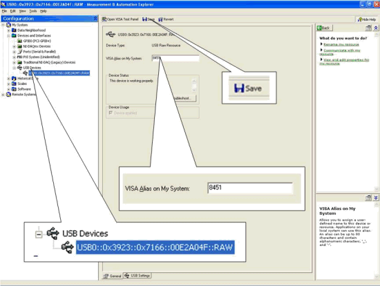

  2. After completing the Microsoft Windows installation procedure, open Measurement & Automation Explorer (MAX) and expand the Devices and Interfaces folder. Because the USB-8451 is installed as a RAW USB device, it appears under USB devices as shown in figure 2.
  3. To configure a VISA alias for use in LabVIEW, expand the USB Devices folder, left click on the USB-8451 and enter a new VISA alias in the text box entitled VISA Alias on My System.
  4. After a new name has been entered, click Save and then exit MAX.
Figure 3. In MAX, the USB-8451 appears under My System >> Devices and Interfaces >> USB Devices. To change the VISA alias, left click on the USB-8451 under USB Devices, enter a new “VISA Alias on My System,” and click Save.

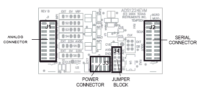

Figure 4. Texas Instruments ADS1224EVM Board Layout.
The ADS1224EVM contains three header blocks for connecting the analog input signal, power supply, and serial output. In addition, a series of switches and jumpers are available to configure settings such as the ADC voltage reference, the input select, and the digital power select. Before making any connections to the evaluation module or writing any code, we must examine the data sheet for the ADS1224 and the ADS1224EVM to determine the proper jumper and switch settings to place the ADS1224EVM in a mode compatible with the USB-8451.

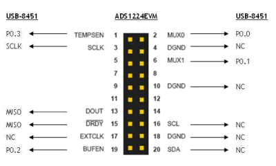

Serial Output Connector – J2
  • SCLK (pin 3) is connected to USB-8451 SCLK output
  • DOUT/DRDY are connected to USB-8451 MISO line
  • MUX0, MUX1, BUFEN, and TEMPSEN are connected to the USB-8451 digital lines P0.0, P0.1, P0.2, and P0.3, respectively
Figure 7. Header block for the Texas Instruments ADS1224EVM serial output. The arrows indicate the connections to the USB-8451 used in this demonstration.

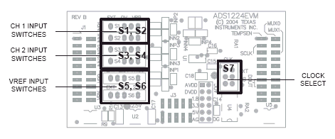

Slide Switches
The slide switches on the ADS1224EVM configure what kind of signal is input to the ADC, whether we want to measure an onboard reference to test the accuracy of the ADC, or we want to configure the ADS1224 to perform a single-ended or differential measurement. The following switch settings were used in this evaluation.

Figure 8. Slide Switches (S1-S7) on the Texas Instruments ADS1224EVM

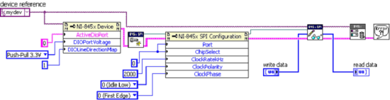

The LabVIEW API provided for the USB-8451 provides two different APIs for programming I2C and SPI devices. The first method, known as the Basic API, involves using a minimum number of LabVIEW functions and is best suited for simple communication schemes that comply with the timing characteristics of the USB-8451. Figure 7, shown below, is an example of the LabVIEW API for basic SPI communication. The program can be broken into three distinct pieces. The first piece configures the 845x device by specifying the desired behavior of the digital lines. The second piece configures the SPI specific features such as the SCLK rate, the clock phase, the clock polarity, and the chip select line to use. This simple methodology will work for many devices, but the TI ADS1224 requires more advanced control over the specific timing of its serial communications. Specifically, the simple method of communication performs serial operations at a speed that is too fast for the ADS1224 to keep up. This results in corrupted data and inconsistent results. To solve this problem, we can use the Advanced API for the USB-8451that provide scripting functionality to effectively create custom transactions of the serial operations you wish to perform.
Figure 9. Simple SPI Example Using the LabVIEW Basic SPI VIs

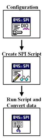

When designing our program, we can break it into three pieces. The first piece is configuration. Here we configure the digital lines used to determine which analog input channel we are going to read, whether or not we are enabling the on-board buffer circuit, and whether we are going to read the on-board temperature sensor. In addition, we configure the properties of the serial clock such as the clock rate, polarity, and phase.
The second piece of the program is the script that will define how the serial protocol will function. For our program, we will set digital lines, wait for a period of time, and then clock out 24-bits of data (one conversion result). Finally, we execute the script we created on the USB-8451, transfer the data obtained, and perform the appropriate conversion on the data. In the case of the ADS1224, the data transferred is in the form of binary twos-complement. A custom VI was created, twos complement to voltage.vi, that converts the output data from the ADS1224 to voltage.
Figure 10. Programming Architecture for Example Program

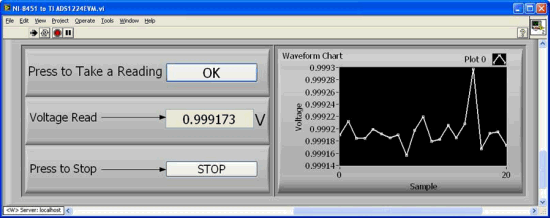

The example program, attached below, is an implementation of the concepts and ideas discussed in the previous sections. The VI will communicate through the USB-8451 to the TI ADS1224 each time the “Press to take a Reading” button is pushed. Each reading will then be stored in a waveform chart.
Figure 11. Screenshot of Example VI Measuring a 1 VDC Source
