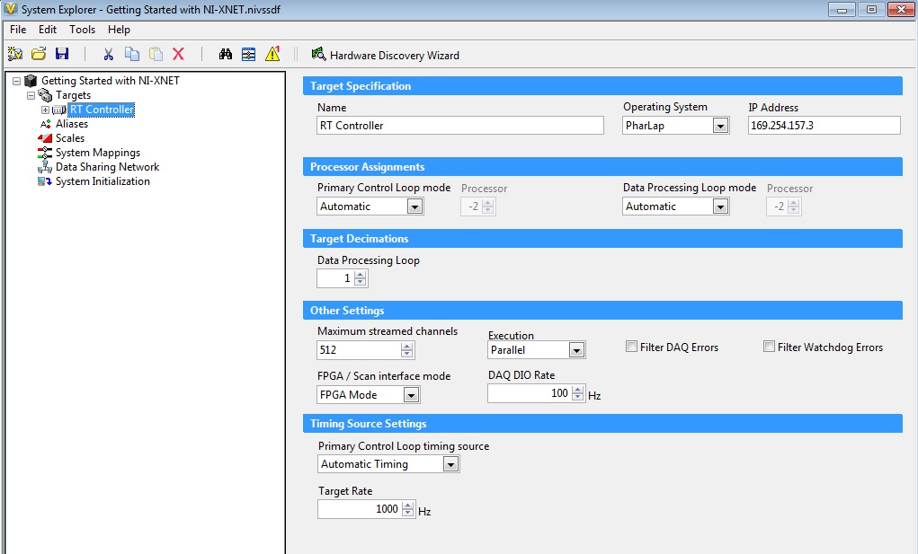

NI VeriStand Project Setup
NI VeriStand uses projects to help get up and running quickly. To set up the project correctly and understand all the available options, complete the Create a Project section in the Getting Started with NI VeriStand tutorial.
Figure 1. The controller specification screen enables NI VeriStand to communicate with the appropriate device and at the specified target rate.
Configure the NI VeriStand Engine and Project with NI-XNET

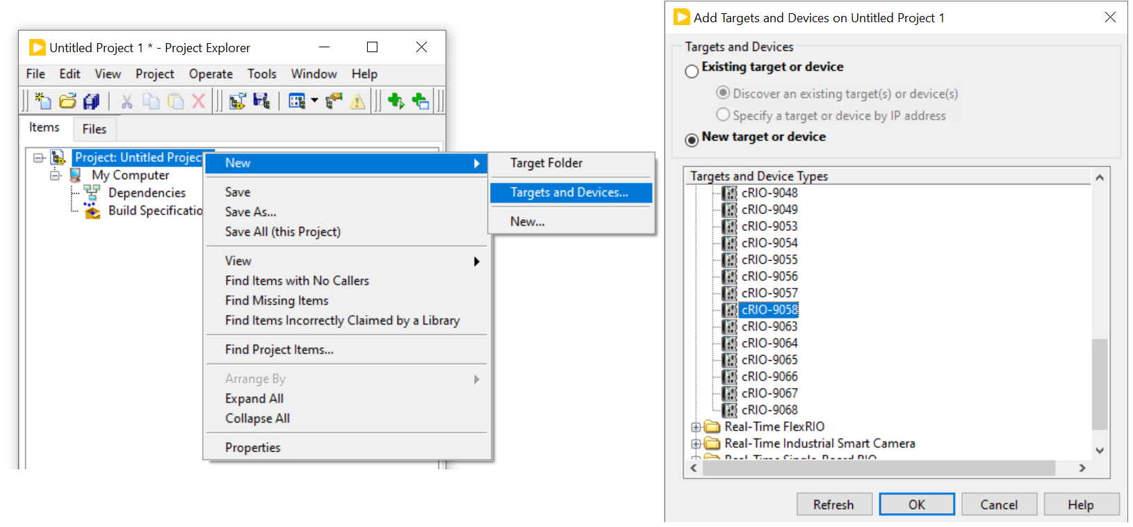

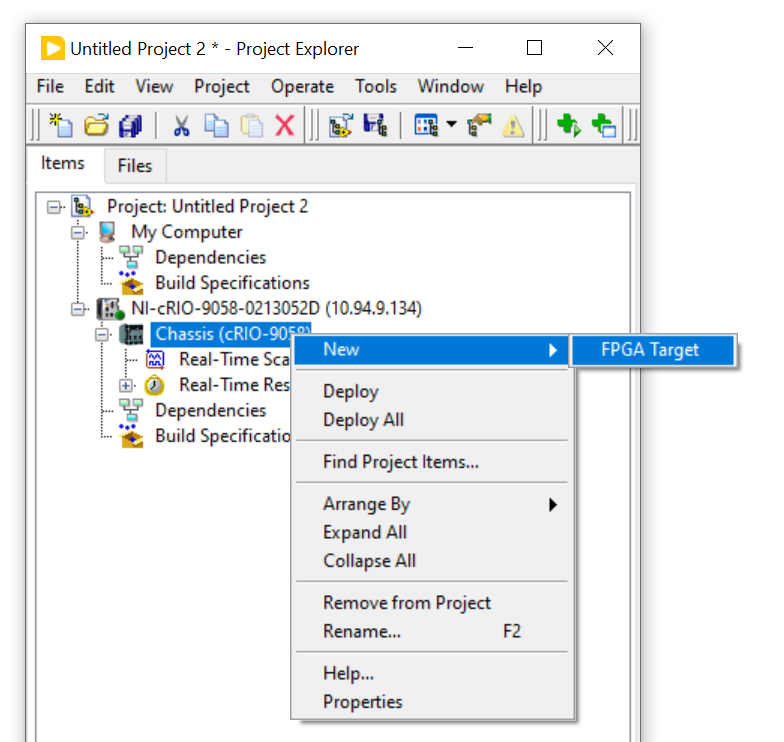

1. Create a blank NI LabVIEW project.
2. Add an NI CompactRIO target.
Figure 2. To specify the hardware in the system, add the NI CompactRIO target to the NI LabVIEW project
3. Add an FPGA Target.

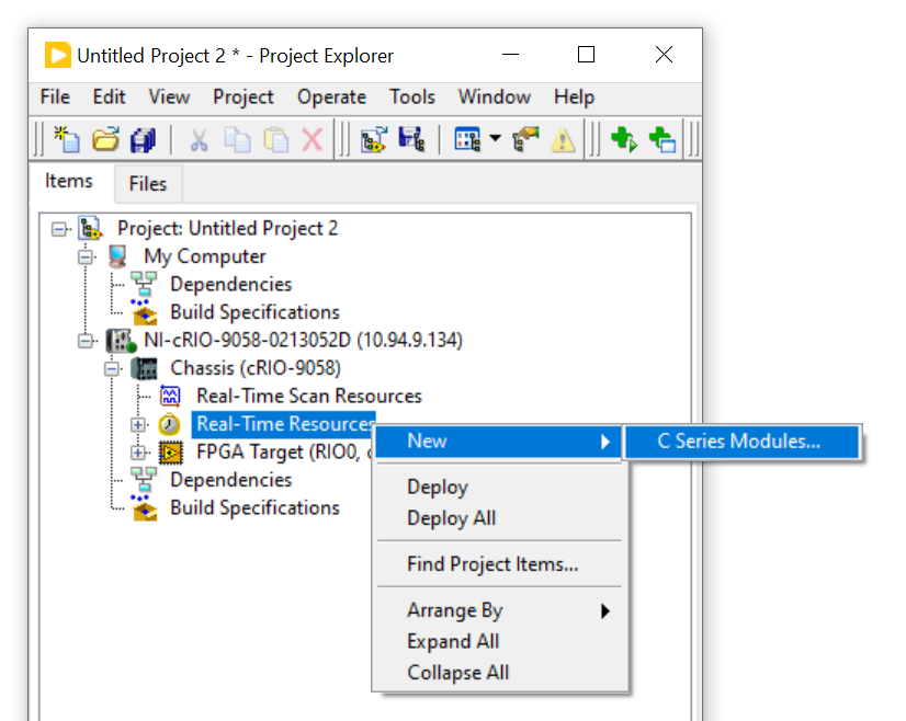

4. Add an NI 986x XNET Module.
Figure 4. Add an NI 986x XNET module to the NI LabVIEW project.

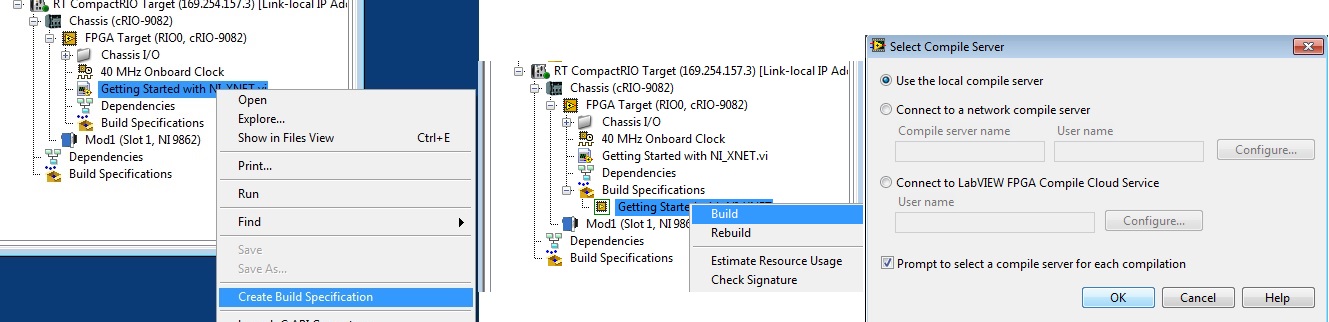

8. Compile VI.
Figure 5. Create a bitfile to use in NI VeriStand by compiling the VI in the NI LabVIEW project.

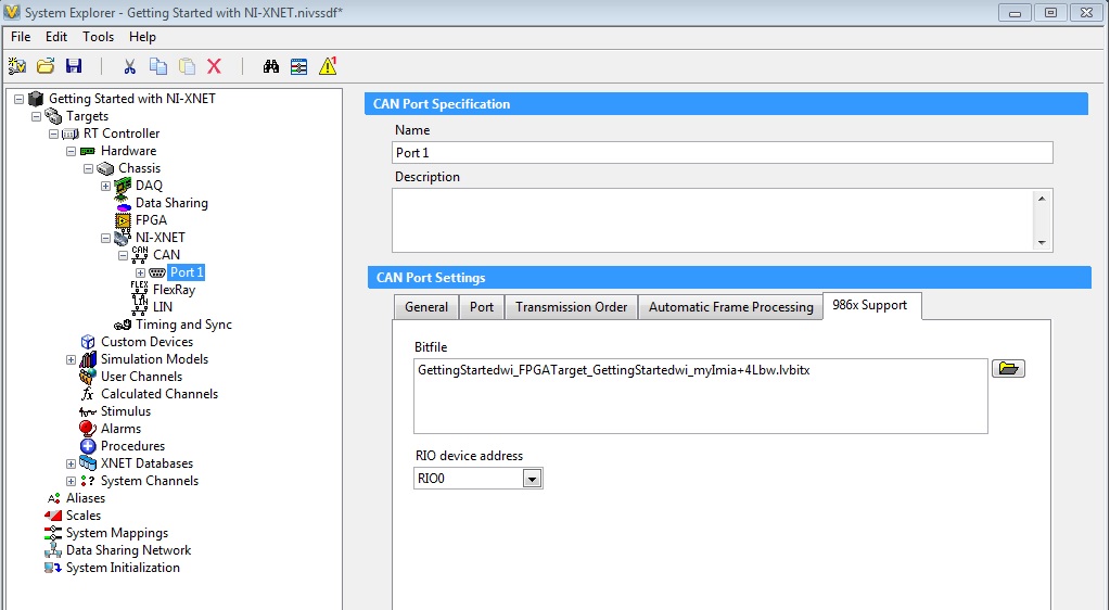

9. Add CAN or LIN port.
Figure 6. Add NI-XNET port to NI VeriStand.
10. Add the bitfile to the port that was created.
Figure 7. Add the bitfile to the communication port.

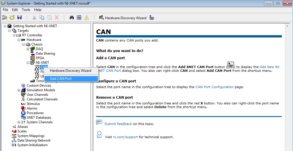

Adding a CAN, LIN, or FlexRay Port
An interface represents a single CAN, LIN or FlexRay connector on an NI hardware device. NI-XNET also uses the term port to refer to the connector on an NI hardware device. Configure a NI-XNET session in NI VeriStand by simply adding ports under the appropriate protocol. To add a port to NI VeriStand, follow the steps in Adding NI-XNET Devices NI VeriStand Help for your appropriate NI-XNET device.
Figure 8. Add NI-XNET Port to NI VeriStand.
Once the appropriate NI-XNET port has been added, configure additional settings for the port through the protocols configuration page.

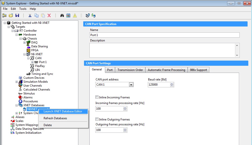

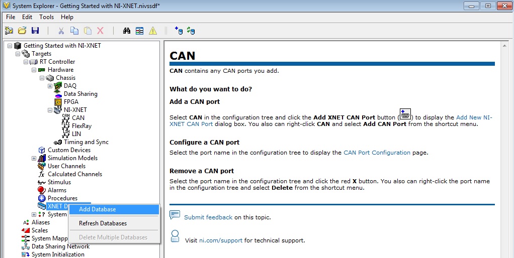

Add a NI-XNET Database to NI VeriStand
For the NI-XNET interface to communicate with hardware products on the external network, NI-XNET must understand the communication in the actual embedded system, such as the vehicle. This embedded communication is described within a standardized file, such as a CANdb (.dbc) for CAN, FIBEX (.xml) for FlexRay, or LIN description file (.ldf) for LIN. Within NI-XNET, this file is referred to as a database. Complete the steps in the Adding NI-XNET Databases NI VeriStand Help to add a database in NI VeriStand. An example database can be found at <Public\Documents\National Instruments\NI-XNET\Examples>.
Figure 9. Add a database to NI VeriStand for NI-XNET to interpret the communication in the embedded system.

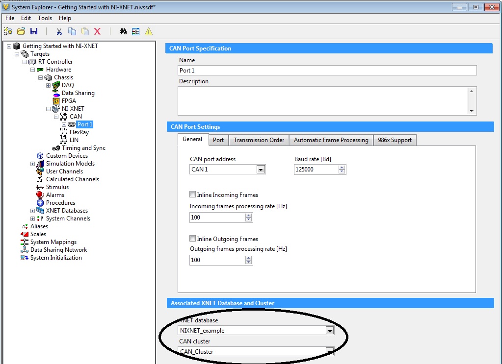

Once you have added your database, you can select the database on the NI-XNET Port configuration page.
Figure 10. Associate the appropriate database (demonstrated in the circle) to the NI-XNET port that has been created.
Edit a Database from NI VeriStand
Now that the database has been added, the NI-XNET Database Editor can be used to edit the database directly from NI VeriStand. The NI-XNET Database Editor is a small standalone tool for creating and maintaining embedded network databases. The editor is used to configure the basic network, define frames and signals exchanged on the network and assign frames to ECUs that send and receive them.  Launch the NI-XNET Database Editor by following the Editing NI-XNET Databases NI VeriStand Help.
Figure 11. Launch the NI-XNET Database Editor to edit databases directly in NI VeriStand.

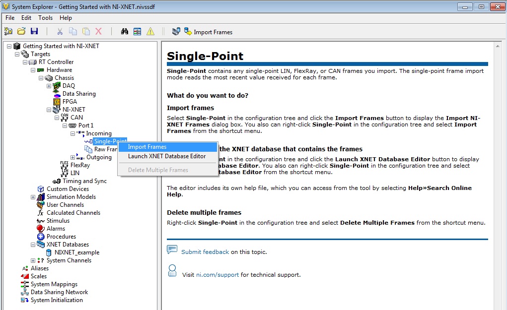

Importing Frames into NI VeriStand
Frames are messages transmitted across an embedded network. These messages are sorted into clusters with a database. In NI VeriStand, frames can be either inputs (incoming frames) or outputs (outgoing frames). Follow the steps in the Importing NI-XNET Frames NI VeriStand Help to import your NI-XNET frames into NI VeriStand after the NI-XNET database has been added.
Figure 12. Import frames into NI VeriStand.

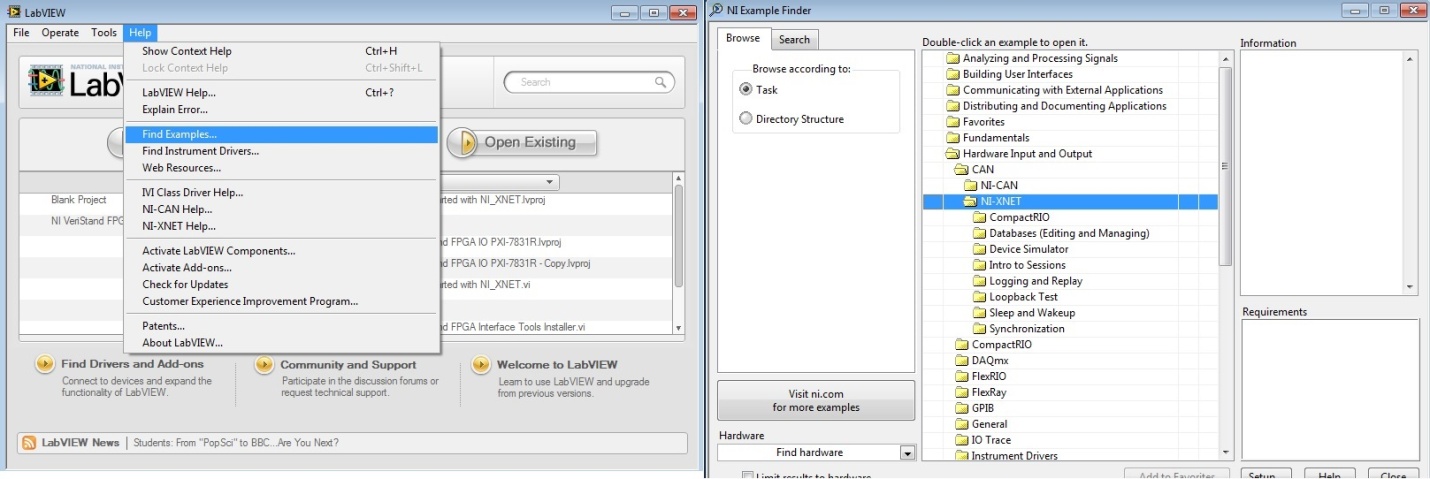

To help with the getting-started process, NI LabVIEW provides examples for NI-XNET. When the LabVIEW start menu is available, choose Find Examples from the NI LabVIEW Help menu.
Figure 13. The NI-XNET examples provide great references or starting points.
Browse examples by task, NI-XNET examples are under Hardware Input and Output. The examples are grouped by protocol in CAN, FlexRay and LIN folders.
