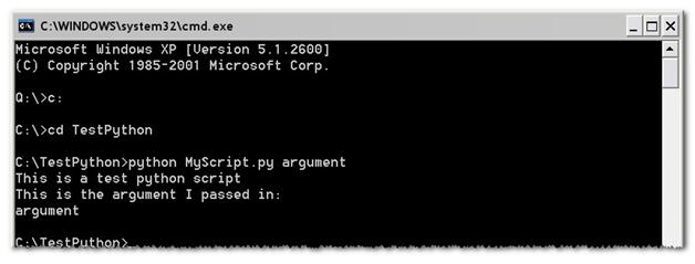

Calling Perl and Python Scripts From the Command Line
  1. Select Start»Run
  2. Enter cmd to launch the command line
  3. Navigate to the directory where the Perl or Python script is saved
  4. To call the interpreter that will execute the script use the following command(s):
For Perl scripts, use:  'perl scriptName.pl argument' as shown in the image below.
For Python scripts, use:  'python  scriptName.py argument' as shown in the image below.
