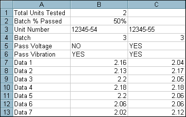

Figure 1 shows the original worksheet you created at the end of the first part of this tutorial. You can compare this example to the final report after you finish this part of the tutorial.
Figure 1: Original Worksheet from Part 1

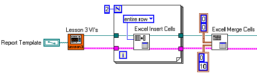

To finish the report, add a title and some text with descriptive information like the data and the name of the operator monitoring the test station. Before you add these elements to the report, you must create space at the top of the report to avoid overwriting any existing cells. Use the Excel Insert Cells VI to add space at the top of the report for a title and introductory text. For the title to span the length of the report across multiple columns, you also can merge those cells together using the Excel Merge Cells VI.

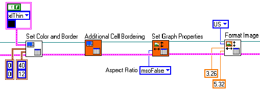

At this point, all the data and information you want in the report is included. To improve report layout, you can add borders and reposition objects, including graphs. Use the Excel Set Cell Color and Border VI to customize cell properties, and use the Excel Image Format VI to customize the graph size.
Figure 4. Customizing Cell Properties in an Excel Worksheet

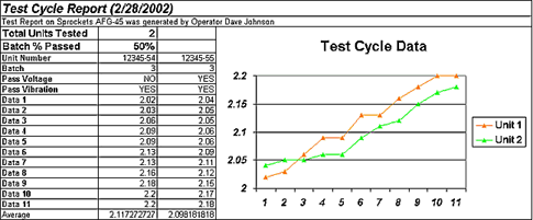

Figure 5 shows the added white space, title, and customized cells. You have created a report that greatly improves the original layout you generated in Figure 1. You now can save or distribute the final product. You can use the toolkit to e-mail, print, or save the report in Excel format. Doing so removes the need for the operator to manually adjust the report, which can save test time and ensure report quality.
Figure 5. Final Test Cycle Report in an Excel Worksheet
